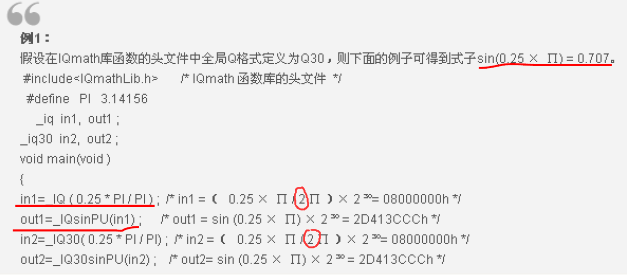

关于IQmath函数中的iqsinpu()函数
iqsinpu()函数的例子中,int1的注释里,为什么是除以2π,而不是π?是例子写错了吗?

    请参考controlsuite中的IQmath user’s Guide:\ti\controlSUITE\libs\math\IQmath\v160\doc
    #include “IQmathLib.h”
    #define PI 3.14156
    _iq in1, out1;
    _iq30 in2, out2;
    void main(void ){
    // in1 = in2 = (0.25 x PI)/(2PI) x 2^30
    // = (.25/2) x 2^30 = 0x08000000 or .125
    // out1 = out2 = sinPU(0.25/2) x 2^30 = 0x2D413CCC or .707
    in1 =_IQ(0.25L/2.0L);
    out1 =_IQsinPU(in1)
    in2 =_IQ30(0.25*PI/PI);
    out2 =_IQ30sinPU(in2);
