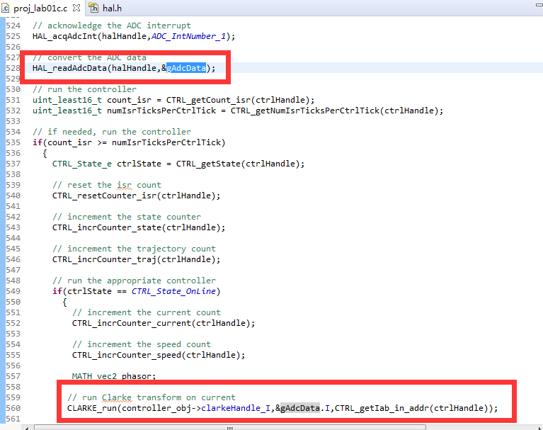

InstaSpin-FOC历程中初始化了电流滤波器,但没有使用是什么情况
最近学习TI的InstaSpin-FOC,看见里面初始化了滤波器参数,但程序没用到滤波器过滤电流。是我没找到操作代码还是程序中就没用。
下面是电流读取代码到clarke部分;下面是Lab 1C 。
HHAL_readAdcData中只从ADC寄存器中读取了滤波器ADC值,并进行了简单的比例和IQ转化,没有滤波;
CLARKE_run中直接进行clarke变化,也没有滤波。
剩下代码中都没有关于adc的操作。
既然InstaSPIN 初始化了滤波器参数,为什么不用呢?
TI demo板有一个RC 低通滤波器,截止频率在450KHZ,远不能滤除噪声。必定还要其他滤波才能行。但一直没找到。
谁能帮我解答一下。
static inline void HAL_readAdcData(HAL_Handle handle,HAL_AdcData_t *pAdcData)
  HAL_Obj *obj = (HAL_Obj *)handle;
  _iq value;
  _iq current_sf = HAL_getCurrentScaleFactor(handle);
  _iq voltage_sf = HAL_getVoltageScaleFactor(handle);
  // convert current A
  // sample the first sample twice due to errata sprz342f, ignore the first sample
  value = (_iq)ADC_readResult(obj->adcHandle,ADC_ResultNumber_1);
  value = _IQ12mpy(value,current_sf) - obj->adcBias.I.value[0];      // divide by 2^numAdcBits = 2^12
  pAdcData->I.value[0] = value;
  // convert current B
  value = (_iq)ADC_readResult(obj->adcHandle,ADC_ResultNumber_2);
  value = _IQ12mpy(value,current_sf) - obj->adcBias.I.value[1];      // divide by 2^numAdcBits = 2^12
  pAdcData->I.value[1] = value;
  // convert current C
  value = (_iq)ADC_readResult(obj->adcHandle,ADC_ResultNumber_3);
  value = _IQ12mpy(value,current_sf) - obj->adcBias.I.value[2];      // divide by 2^numAdcBits = 2^12
  pAdcData->I.value[2] = value;
  // convert voltage A
  value = (_iq)ADC_readResult(obj->adcHandle,ADC_ResultNumber_4);
  value = _IQ12mpy(value,voltage_sf) - obj->adcBias.V.value[0];      // divide by 2^numAdcBits = 2^12
  pAdcData->V.value[0] = value;
  // convert voltage B
  value = (_iq)ADC_readResult(obj->adcHandle,ADC_ResultNumber_5);
  value = _IQ12mpy(value,voltage_sf) - obj->adcBias.V.value[1];      // divide by 2^numAdcBits = 2^12
  pAdcData->V.value[1] = value;
  // convert voltage C
  value = (_iq)ADC_readResult(obj->adcHandle,ADC_ResultNumber_6);
  value = _IQ12mpy(value,voltage_sf) - obj->adcBias.V.value[2];      // divide by 2^numAdcBits = 2^12
  pAdcData->V.value[2] = value;
  // read the dcBus voltage value
  value = (_iq)ADC_readResult(obj->adcHandle,ADC_ResultNumber_7);     // divide by 2^numAdcBits = 2^12
  value = _IQ12mpy(value,voltage_sf);
  pAdcData->dcBus = value;
  return;
} // end of HAL_readAdcData() function
static inline void CLARKE_run(CLARKE_Handle handle,const MATH_vec3 *pInVec,MATH_vec2 *pOutVec)
  CLARKE_Obj *obj = (CLARKE_Obj *)handle;
  uint_least8_t numSensors = obj->numSensors;
  _iq alpha_sf = obj->alpha_sf;
  _iq beta_sf = obj->beta_sf;
  if(numSensors == 3)
      pOutVec->value[0] = _IQmpy(lshft_1(pInVec->value[0]) - (pInVec->value[1] + pInVec->value[2]),alpha_sf);
      pOutVec->value[1] = _IQmpy(pInVec->value[1] - pInVec->value[2],beta_sf);
  else if(numSensors == 2)
      pOutVec->value[0] = _IQmpy(pInVec->value[0],alpha_sf);
      pOutVec->value[1] = _IQmpy(pInVec->value[0] + lshft_1(pInVec->value[1]),beta_sf);
  return;
} // end of CLARKE_run() function
