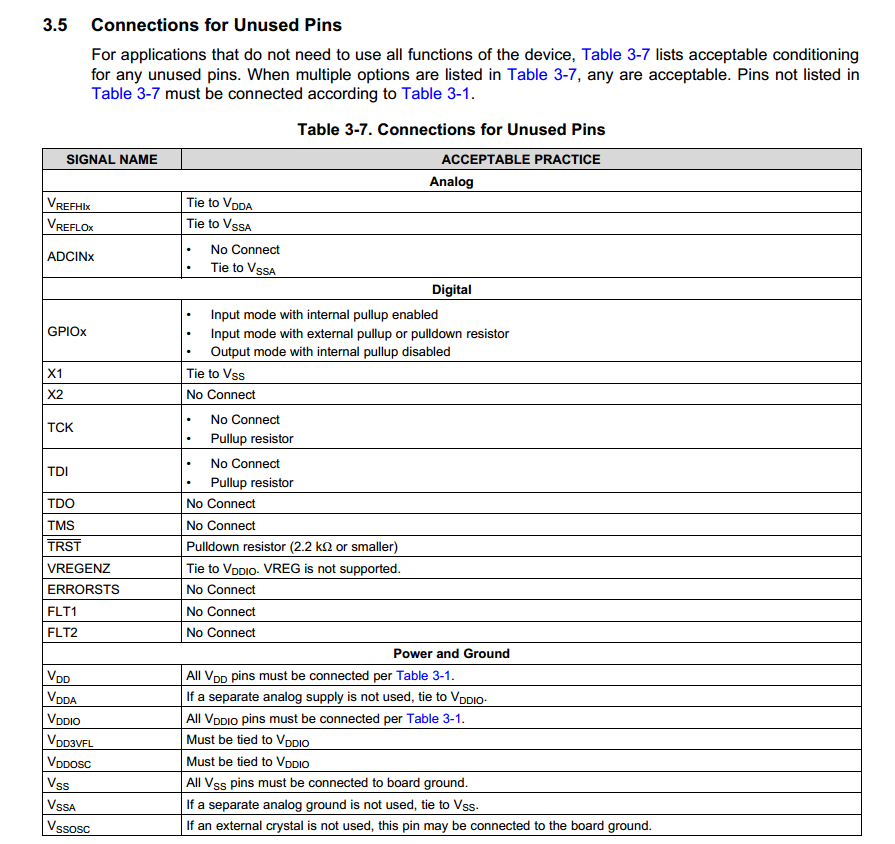

TMS320F28377DZWT不外扩Flash,DSP上的R11,R12电源引脚可悬空,还是必须要接3.3V电源?
  • 没看到手册里有讲    不确定怎么处理    建议还是接上
  • 必须接到3.3V,避免悬空后引脚电平不确定
  • 5.8.1 Power Sequencing
    An external power supply must be used to supply 3.3 V to VDDIO, VDD3VFL, VDDOSC, and VDDA and to
    provide 1.2 V to VDD. The internal VREG is not supported; therefore, the VREGENZ pin must be tied high
    to 3.3 V. The supplies should ramp to full rail within 10 ms. Table 5-3 shows the supply ramp rate.
