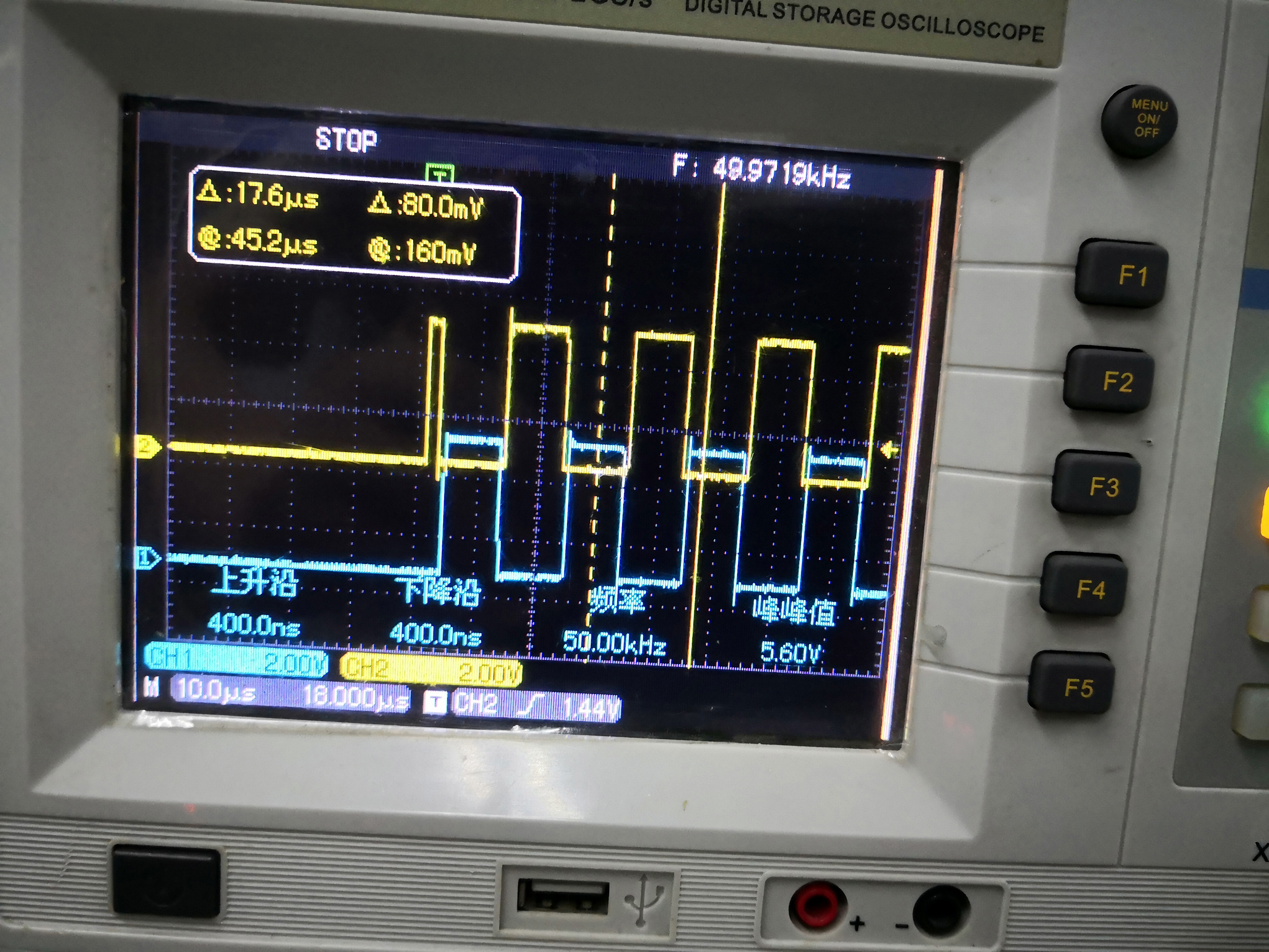

void SetPwmStop_Downbridge(void)
EALLOW;
EPwm6Regs.TZFRC.bit.OST = 1; // disable
EDIS;
void SetPwmStart_Downbridge(void)
EALLOW;
EPwm6Regs.TZCLR.bit.OST = 1; // enable
EPwm6Regs.TZCLR.bit.INT = 1;
EDIS;
也试过开启时,清除计数器的值,量是现象一样!
EALLOW;
EDIS;
EALLOW;
EDIS;
