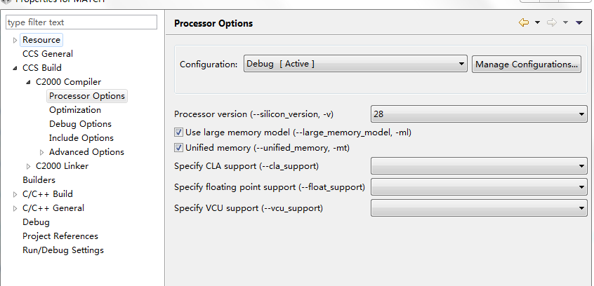

看看应该有类似的设置
It sounds like perhaps the compiler options are not set to compile for the 28x. Can you check that -v28 is being used in the compiler options? It should be set by default in all of the TI example projects.
