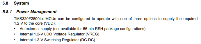

您好,您可参考F280049 Datasheet 5.8.1章节:http://www.ti.com/lit/ds/sprs945c/sprs945c.pdf
