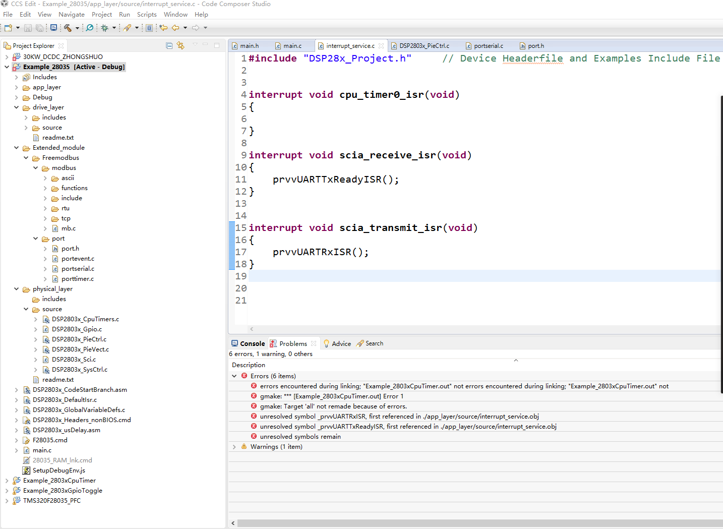

函数调用报错 first referenced 。。。。。。.obj

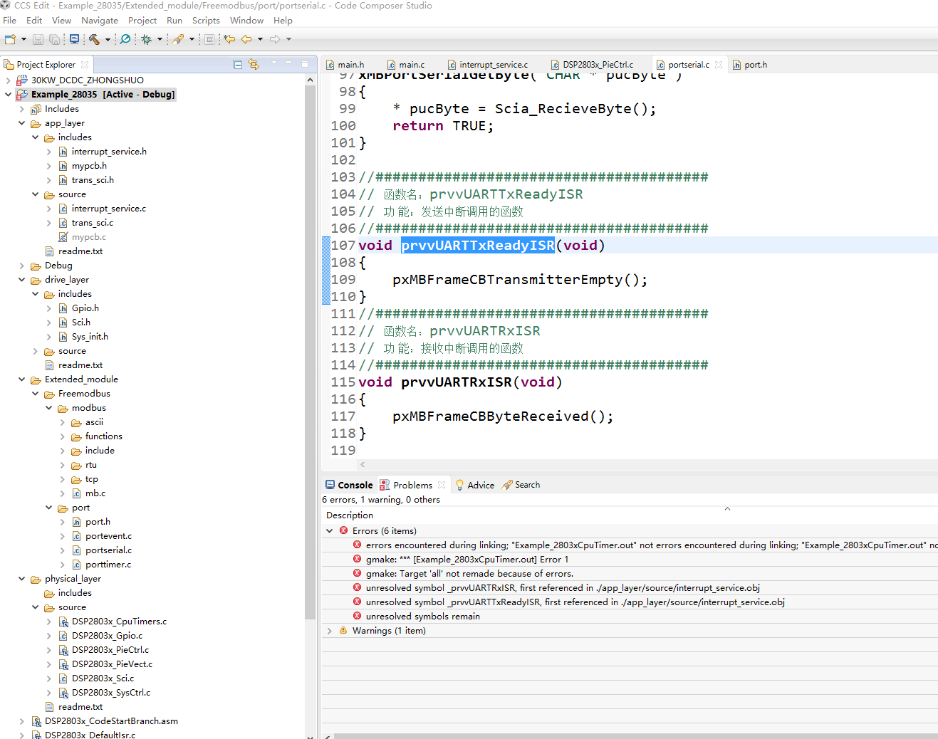

引用 这个prvvUARTxReadyISR()和prvvUARTRxISR()就会报错  我已经尝试将文件夹都加入头文件和库文件了还是有问题  函数本体如下图

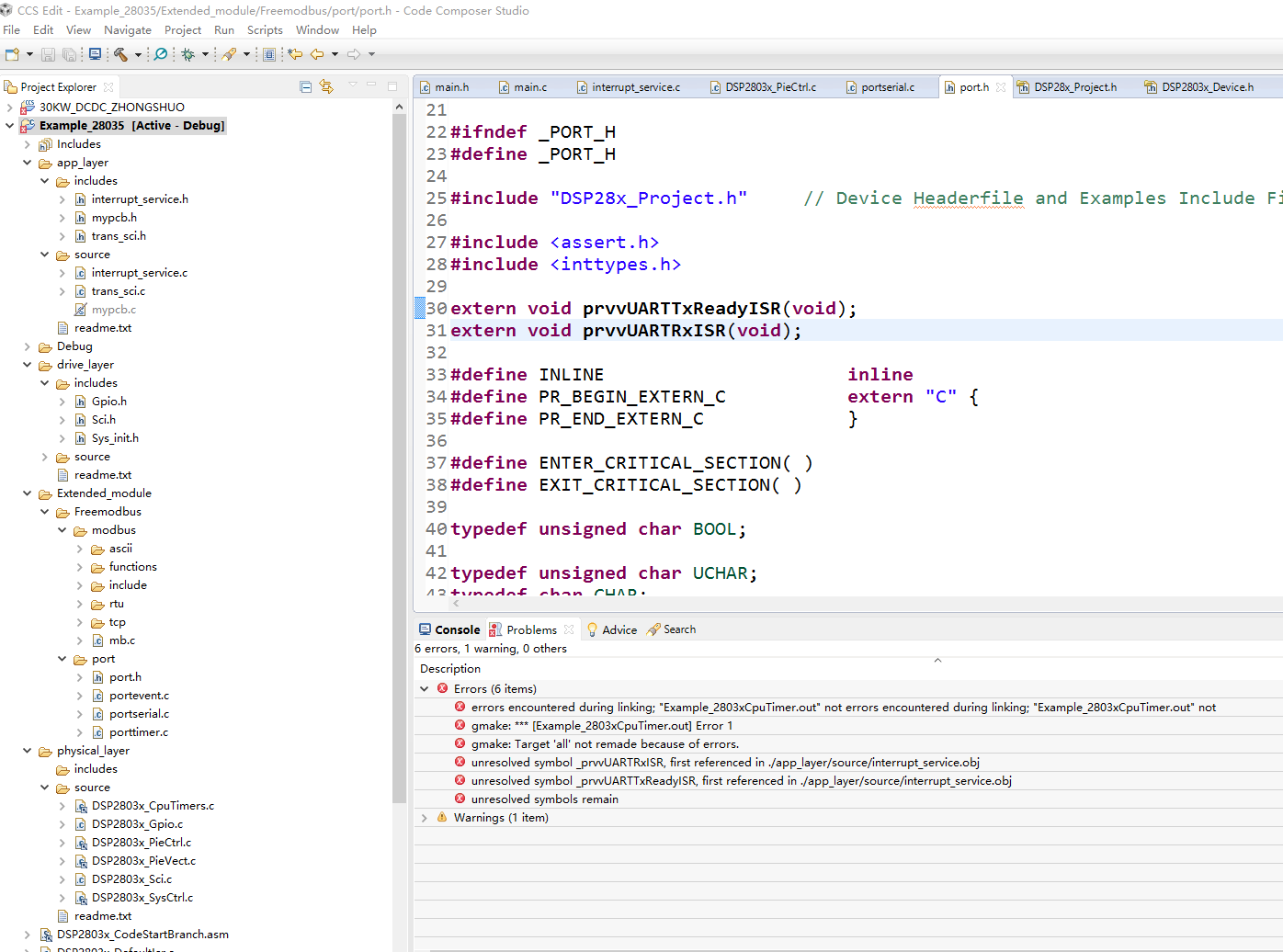

函数声明如下图

  • 如果把这两个函数不调用就没有报错
  • 能否给出 build log?有可能是因为您的main.c被编译了而portserial.c没有被编译

  • **** Build of configuration Debug for project Example_28035 ****
    "D:\\software\\CCS6_2\\ccsv6\\utils\\bin\\gmake" -k all

    'Building file: ../app_layer/source/interrupt_service.c'
    'Invoking: C2000 Compiler'
    "D:/software/CCS6_2/ccsv6/tools/compiler/c2000_15.12.3.LTS/bin/cl2000" -v28 -ml -mt --cla_support=cla0 --preinclude="E:/CCS_Workspace/Example_28035/Extended_module/Freemodbus/port/port.h" --include_path="E:/CCS_Workspace/Example_28035/app_layer/includes" --include_path="E:/CCS_Workspace/Example_28035/Extended_module/Freemodbus/port" --include_path="E:/CCS_Workspace/Example_28035/Extended_module/Freemodbus/modbus/ascii" --include_path="E:/CCS_Workspace/Example_28035/Extended_module/Freemodbus/modbus/functions" --include_path="E:/CCS_Workspace/Example_28035/Extended_module/Freemodbus/modbus/include" --include_path="E:/CCS_Workspace/Example_28035/Extended_module/Freemodbus/modbus/rtu" --include_path="E:/CCS_Workspace/Example_28035/Extended_module/Freemodbus/modbus/tcp" --include_path="E:/CCS_Workspace/Example_28035/drive_layer/includes" --include_path="D:/software/CCS6_2/ccsv6/tools/compiler/c2000_15.12.3.LTS/include" --include_path="E:/CCS_Workspace/Example_28035/physical_layer/includes" --include_path="D:/software/CCS6_2/controlSUITE/device_support/f2803x/v130/DSP2803x_headers/include" --include_path="D:/software/CCS6_2/controlSUITE/device_support/f2803x/v130/DSP2803x_common/include" --include_path="D:/software/CCS6_2/controlSUITE/libs/math/IQmath/v160/include" -g --define="_DEBUG" --define="LARGE_MODEL" --quiet --verbose_diagnostics --diag_warning=225 --diag_suppress=10063 --issue_remarks --output_all_syms --cdebug_asm_data --preproc_with_compile --preproc_dependency="app_layer/source/interrupt_service.d" --obj_directory="app_layer/source"  "../app_layer/source/interrupt_service.c"
    'Finished building: ../app_layer/source/interrupt_service.c'
    'Building target: Example_2803xCpuTimer.out'
    'Invoking: C2000 Linker'
    "D:/software/CCS6_2/ccsv6/tools/compiler/c2000_15.12.3.LTS/bin/cl2000" -v28 -ml -mt --cla_support=cla0 --preinclude="E:/CCS_Workspace/Example_28035/Extended_module/Freemodbus/port/port.h" -g --define="_DEBUG" --define="LARGE_MODEL" --quiet --verbose_diagnostics --diag_warning=225 --diag_suppress=10063 --issue_remarks --output_all_syms --cdebug_asm_data -z -m"Example_2803xCpuTimer.map" --stack_size=0x200 --warn_sections -i"D:/software/CCS6_2/ccsv6/tools/compiler/c2000_15.12.3.LTS/lib" -i"D:/software/CCS6_2/ccsv6/tools/compiler/c2000_15.12.3.LTS/include" -i"E:/CCS_Workspace/Example_28035" -i"D:/software/CCS6_2/controlSUITE/device_support/f2803x/v130/DSP2803x_common/lib" -i"D:/software/CCS6_2/controlSUITE/libs/math/IQmath/v160/lib" --reread_libs --verbose_diagnostics --issue_remarks --xml_link_info="Example_2803xCpuTimer_linkInfo.xml" --entry_point=code_start --rom_model -o "Example_2803xCpuTimer.out" "./DSP2803x_CodeStartBranch.obj" "./DSP2803x_DefaultIsr.obj" "./DSP2803x_GlobalVariableDefs.obj" "./DSP2803x_usDelay.obj" "./main.obj" "./app_layer/source/interrupt_service.obj" "./app_layer/source/trans_sci.obj" "./drive_layer/source/Gpio.obj" "./drive_layer/source/Sci.obj" "./drive_layer/source/Sys_init.obj" "./physical_layer/source/DSP2803x_CpuTimers.obj" "./physical_layer/source/DSP2803x_Gpio.obj" "./physical_layer/source/DSP2803x_PieCtrl.obj" "./physical_layer/source/DSP2803x_PieVect.obj" "./physical_layer/source/DSP2803x_Sci.obj" "./physical_layer/source/DSP2803x_SysCtrl.obj" "D:/software/CCS6_2/controlSUITE/device_support/f2803x/v130/DSP2803x_headers/cmd/DSP2803x_Headers_nonBIOS.cmd" "../F28035.cmd"  -lrts2800_ml.lib -lIQmath.lib
    >> Compilation failure
    makefile:169: recipe for target 'Example_2803xCpuTimer.out' failed
     undefined           first referenced
      symbol                 in file
     _prvvUARTRxISR      ./app_layer/source/interrupt_service.obj
     _prvvUARTTxReadyISR ./app_layer/source/interrupt_service.obj
    error: unresolved symbols remain
    error: errors encountered during linking; "Example_2803xCpuTimer.out" not
       built
    gmake: *** [Example_2803xCpuTimer.out] Error 1
    gmake: Target 'all' not remade because of errors.
    **** Build Finished ****
    这就是我的编译日志
