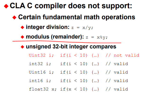

在28377D的CLA1代码中使用取余操作(cnt % 10),提示:
(Performance) Signed modulo operation was not eliminated during optimization. Using inefficient fallback; consider modifying code to not require this operation.
这个如何处理?谢谢!
