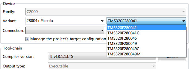

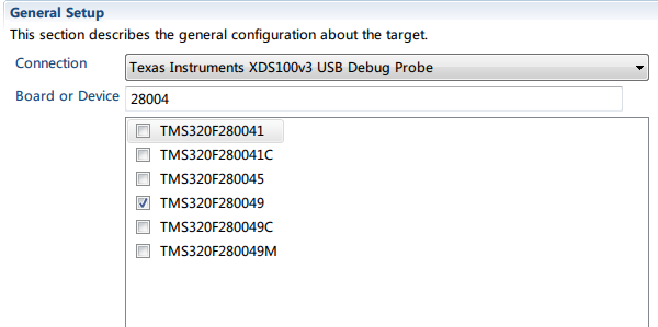

使用TMS320F280040 DSP时CCS中没有这个IC可以选择该如何解决?
是的,我的也是这种情况。我给E2E回复了,让我们一起等一下他们的方法吧
请您看一下最新回复
For the time being please use the F280041 board for the F280040 device. In terms of what CCS configues, the memory map and periperals in the 41 and 40 are the same. The key difference is that the 40 has 2 fewer GPIOs in the 64 pin variant, and is Q grade only.
I will file a ticket to get both the 280040 and 280048 added to the drop down in CCS.
