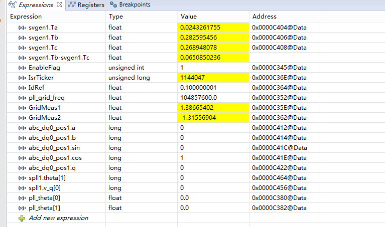

三相SRF锁相环IQ格式.h文件有问题,我输出的频率根本不对 这是我的调试程序,请帮我看一下哪里有问题,谢谢

#if (BUILDLEVEL==LEVEL1)
    rg1.Freq = (float32)(AC_FREQ); //
    rg1.StepAngleMax = (float32)(1.0/INV_PWM_SWITCHING_FREQUENCY);
    RG_MACRO(rg1)
    //  使用SPLL模块
       int i;
       voltage[Va] = A*_IQsin(DEG_TO_RAD*theta[Va]);
       voltage[Vb] = A*_IQsin(DEG_TO_RAD*theta[Vb]);
       voltage[Vc] = A*_IQsin(DEG_TO_RAD*theta[Vc]);
       for(i=0;i<3;i++)
           theta[i] = theta[i] + 0.9;
           if(theta[i] >= 360)
               theta[i] = theta[i] - 360;
       for(i=0;i<3;i++)
           Vmeas[i] = voltage[i]/230;
       GridMeas1=(Vmeas[Va]);
       GridMeas2=(Vmeas[Vb]);
       GridMeas3=(Vmeas[Vc]);
         abc_dq0_pos1.a = _IQmpy(GridMeas1,_IQ(0.5));
         abc_dq0_pos1.b = _IQmpy(GridMeas2,_IQ(0.5));
         abc_dq0_pos1.c = _IQmpy(GridMeas3,_IQ(0.5));
         abc_dq0_pos1.sin=_IQsin((spll1.theta[1])<<3);  //Q24 to Q21
         abc_dq0_pos1.cos=_IQcos((spll1.theta[1])<<3);
        ABC_DQ0_POS_IQ_MACRO(abc_dq0_pos1);//Q24 to Q21
       spll1.v_q[0] = (int32)(_IQtoIQ21(abc_dq0_pos1.q)); //SPLL CALL    这里貌似不能使用常量,这好像是错误的起因;你能瞎给值
       SPLL_3ph_SRF_IQ_FUNC(&spll1);               //使用这个不会报错           vq0是输入AC电压瞬时采样值为归一化值,在[-1,1]之内。
      pll_theta[0] = spll1.theta[0];
      pll_theta[1] = spll1.theta[1];
      pll_grid_freq = spll1.fo;
