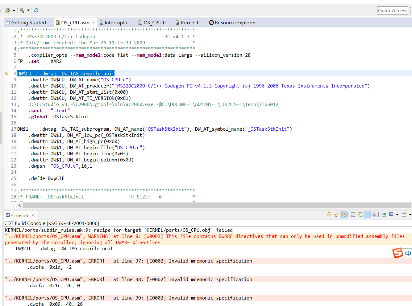

求解答:MCU28034使用ccs6.2编译通过,使用ccs8.2编译不通过,如图
  • 请您试一下下面链接给出的解决方案
    e2e.ti.com/.../734392
    (1) clean the project. The cleaning process does not pass, due to some errors that some files cannot be found.
    (2) change the workspace to a new file. The same error when building the projects.
    (3) delete all the files in the workspace and re-build. The same error.
    (4) I uninstall the CCS (Version 8.0) and re-install the latest version 8.2. No errors anymore.
  • 上面的方法都输试过了,我还是用回6.2的版本了,看来尝试新版本坑太多,不去踩了。。。
    截图很清楚了,看告警是说你这个编译器不支持DW_TAG_compile_uint ,导致所有.dwcfa命令都发生错误!
