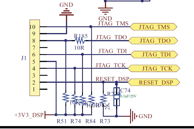

 1、空DSP烧录程式烧录不进去,target 配置、出错信息和JTAG口脚定义如下,请问是什么原因?
 2、空DSP上辅助电源后RESET_DSP脚正常是什么电平?高还是低电平?

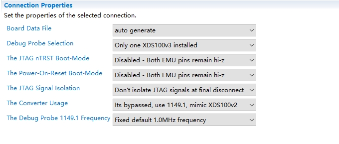

target configer:
1、XDS100V3
2、280049C
3
JTAG烧录出错信息:
Error connecting to the target:
(Error -233 @ 0x0)
The JTAG IR and DR scan-paths cannot circulate bits, they may be broken.
An attempt to scan the JTAG scan-path has failed.
The target's JTAG scan-path appears to be broken
with a stuck-at-ones or stuck-at-zero fault.
(Emulation package 8.0.27.9)
JTAG烧录口如下:
非常感谢!
