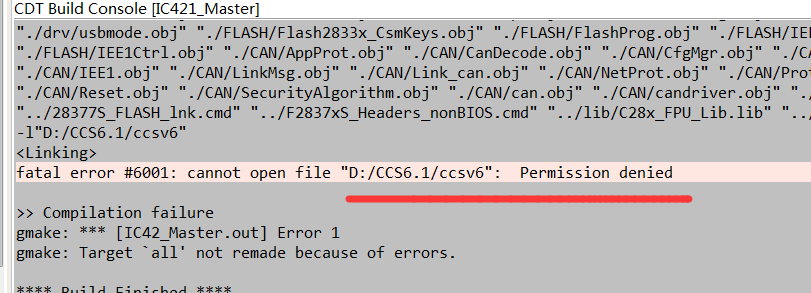

CCS6.1工程编译不通过:fatal error #6001: cannot open file "D:/CCS6.1/ccsv6": Permission denied
Description    Resource    Path    Location    Type
#6001 cannot open file "D:/CCS6.1/ccsv6":  Permission denied    IC421_Master             C/C++ Problem,请问怎么解决呢
  • 您的图片未能成功上传,请您重新上传一下,谢谢!
    另外能否请您稍微详细说明一下您现在的情况?
  • 请问能否给出您的完整错误提示?
    您可以先看一下
    e2e.ti.com/.../566031
    给出的建议
  • **** Clean-only build of configuration Debug for project IC421_Master ****
    "C:\\ti\\ccsv6\\utils\\bin\\gmake" -k clean
    DEL /F  "IC42_Master.out"  "IC42_Master.hex"
    找不到 E:\1_SHANGFUDIAN\SHANGFUDIAN_EMC_DEMO\20181129Code_IC421_M\AppProject\Project\Debug\IC42_Master.out
    DEL /F "KalmanFilter.pp" "RadarSdk.pp" "calc.pp" "data_pro.pp" "track_pro.pp" "user\FreCalib.pp" "user\fpufft.pp" "user\timer.pp" "src\F2837xS_Adc.pp" "src\F2837xS_CpuTimers.pp" "src\F2837xS_DefaultISR.pp" "src\F2837xS_Dma.pp" "src\F2837xS_ECap.pp" "src\F2837xS_EPwm.pp" "src\F2837xS_Emif.pp" "src\F2837xS_GlobalVariableDefs.pp" "src\F2837xS_Gpio.pp" "src\F2837xS_PieCtrl.pp" "src\F2837xS_PieVect.pp" "src\F2837xS_SysCtrl.pp" "drv\WatchDog.pp" "drv\interrupt.pp" "drv\sysctl.pp" "drv\systick.pp" "drv\uart.pp" "drv\uartstdio.pp" "drv\usb.pp" "drv\usb_bulk_structs.pp" "drv\usb_hal.pp" "drv\usbbuffer.pp" "drv\usbdbulk.pp" "drv\usbdcdc.pp" "drv\usbdcomp.pp" "drv\usbdconfig.pp" "drv\usbkeyboardmap.pp" "drv\usbmode.pp" "FLASH\FlashProg.pp" "FLASH\IEE1.pp" "FLASH\IEE1Ctrl.pp" "CAN\AppProt.pp" "CAN\CanDecode.pp" "CAN\CfgMgr.pp" "CAN\DTCMgr.pp" "CAN\IEE1.pp" "CAN\LinkMsg.pp" "CAN\Link_can.pp" "CAN\NetProt.pp" "CAN\Prottimeout.pp" "CAN\Reset.pp" "CAN\SecurityAlgorithm.pp" "CAN\can.pp" "CAN\candriver.pp" "CAN\power.pp"
    DEL /F "KalmanFilter.obj" "RadarSdk.obj" "calc.obj" "data_pro.obj" "track_pro.obj" "user\FreCalib.obj" "user\fpufft.obj" "user\timer.obj" "src\DCSM_Z1_ZoneSelectBlock.obj" "src\F2837xS_Adc.obj" "src\F2837xS_CodeStartBranch.obj" "src\F2837xS_CpuTimers.obj" "src\F2837xS_DefaultISR.obj" "src\F2837xS_Dma.obj" "src\F2837xS_ECap.obj" "src\F2837xS_EPwm.obj" "src\F2837xS_Emif.obj" "src\F2837xS_GlobalVariableDefs.obj" "src\F2837xS_Gpio.obj" "src\F2837xS_PieCtrl.obj" "src\F2837xS_PieVect.obj" "src\F2837xS_SysCtrl.obj" "src\F2837xS_usDelay.obj" "drv\WatchDog.obj" "drv\interrupt.obj" "drv\sysctl.obj" "drv\systick.obj" "drv\uart.obj" "drv\uartstdio.obj" "drv\usb.obj" "drv\usb_bulk_structs.obj" "drv\usb_hal.obj" "drv\usbbuffer.obj" "drv\usbdbulk.obj" "drv\usbdcdc.obj" "drv\usbdcomp.obj" "drv\usbdconfig.obj" "drv\usbkeyboardmap.obj" "drv\usbmode.obj" "FLASH\Flash2837xs_CsmKeys.obj" "FLASH\FlashProg.obj" "FLASH\IEE1.obj" "FLASH\IEE1Ctrl.obj" "CAN\AppProt.obj" "CAN\CanDecode.obj" "CAN\CfgMgr.obj" "CAN\DTCMgr.obj"
    DEL /F "CAN\IEE1.obj" "CAN\LinkMsg.obj" "CAN\Link_can.obj" "CAN\NetProt.obj" "CAN\Prottimeout.obj" "CAN\Reset.obj" "CAN\SecurityAlgorithm.obj" "CAN\can.obj" "CAN\candriver.obj" "CAN\power.obj"
    DEL /F "src\DCSM_Z1_ZoneSelectBlock.pp" "src\F2837xS_CodeStartBranch.pp" "src\F2837xS_usDelay.pp" "FLASH\Flash2837xs_CsmKeys.pp"
    找不到 E:\1_SHANGFUDIAN\SHANGFUDIAN_EMC_DEMO\20181129Code_IC421_M\AppProject\Project\Debug\src\DCSM_Z1_ZoneSelectBlock.pp
    找不到 E:\1_SHANGFUDIAN\SHANGFUDIAN_EMC_DEMO\20181129Code_IC421_M\AppProject\Project\Debug\FLASH\Flash2837xs_CsmKeys.pp
    'Finished clean'
    **** Build Finished ****

    'Invoking: C2000 Compiler'

    'Building target: IC42_Master.out'
    'Invoking: C2000 Linker'
    "C:/ti/ccsv6/tools/compiler/ti-cgt-c2000_6.4.2/bin/cl2000" -v28 -ml -mt --float_support=fpu32 --tmu_support=tmu0 --advice:performance=all -g --diag_warning=225 --display_error_number --diag_wrap=off -z -m"IC42_Master.map" --stack_size=0x200 --warn_sections -i"C:/ti/ccsv6/tools/compiler/ti-cgt-c2000_6.4.2/lib" -i"C:/ti/ccsv6/tools/compiler/ti-cgt-c2000_6.4.2/include" --reread_libs --priority --disable_auto_rts --display_error_number --diag_wrap=off --xml_link_info="IC421_Master_linkInfo.xml" --rom_model -o "IC42_Master.out" "./KalmanFilter.obj" "./RadarSdk.obj" "./calc.obj" "./data_pro.obj" "./track_pro.obj" "./user/FreCalib.obj" "./user/fpufft.obj" "./user/timer.obj" "./src/DCSM_Z1_ZoneSelectBlock.obj" "./src/F2837xS_Adc.obj" "./src/F2837xS_CodeStartBranch.obj" "./src/F2837xS_CpuTimers.obj" "./src/F2837xS_DefaultISR.obj" "./src/F2837xS_Dma.obj" "./src/F2837xS_ECap.obj" "./src/F2837xS_EPwm.obj" "./src/F2837xS_Emif.obj" "./src/F2837xS_GlobalVariableDefs.obj" "./src/F2837xS_Gpio.obj" "./src/F2837xS_PieCtrl.obj" "./src/F2837xS_PieVect.obj" "./src/F2837xS_SysCtrl.obj" "./src/F2837xS_usDelay.obj" "./drv/WatchDog.obj" "./drv/interrupt.obj" "./drv/sysctl.obj" "./drv/systick.obj" "./drv/uart.obj" "./drv/uartstdio.obj" "./drv/usb.obj" "./drv/usb_bulk_structs.obj" "./drv/usb_hal.obj" "./drv/usbbuffer.obj" "./drv/usbdbulk.obj" "./drv/usbdcdc.obj" "./drv/usbdcomp.obj" "./drv/usbdconfig.obj" "./drv/usbkeyboardmap.obj" "./drv/usbmode.obj" "./FLASH/Flash2837xs_CsmKeys.obj" "./FLASH/FlashProg.obj" "./FLASH/IEE1.obj" "./FLASH/IEE1Ctrl.obj" "./CAN/AppProt.obj" "./CAN/CanDecode.obj" "./CAN/CfgMgr.obj" "./CAN/DTCMgr.obj" "./CAN/IEE1.obj" "./CAN/LinkMsg.obj" "./CAN/Link_can.obj" "./CAN/NetProt.obj" "./CAN/Prottimeout.obj" "./CAN/Reset.obj" "./CAN/SecurityAlgorithm.obj" "./CAN/can.obj" "./CAN/candriver.obj" "./CAN/power.obj" "../28377S_FLASH_lnk.cmd" "../F2837xS_Headers_nonBIOS.cmd" "../lib/C28x_FPU_Lib.lib" "../lib/usblib.lib"  -l"C:/ti/ccsv6" -l"D:\CCS6.1\ccsv6\tools\compiler\ti-cgt-c2000_6.4.2\lib\libc.a" -l"D:\CCS6.1\ccsv6\tools\compiler\ti-cgt-c2000_6.4.2\lib\rts2800_ml.lib"
    <Linking>
    fatal error #6001: cannot open file "C:/ti/ccsv6":  Permission denied
    >> Compilation failure
    gmake: *** [IC42_Master.out] Error 1
    gmake: Target `all' not remade because of errors.
  • 首先谢谢您的回答,我按照您给的方法,并没能解决问题,不知道该如何解决呢
  • 请问您现在CCS是装在C盘还是D盘?您的CCS workspace是在哪个路径下的?您导入的程序是在E盘?
    我对您的路径有点疑惑
  • CCS在c盘,ccs workspace在E盘,程序在E盘,在workspace里
  • CCS安装路径和workspace会有影响吗
