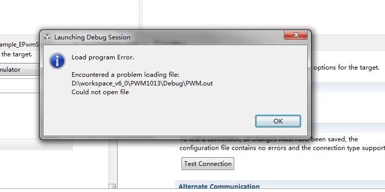

CCS下载时报错 .out could not open file 请问应该如何解决
Other Parts Discussed in Thread: UNIFLASH
用CCS6.0 debug时报错,DSP型号是F28335,具体如图所示,请问应该如何解决呀?
  • 请问是否可以成功编译?您现在使用的是自制的板子还是TI的开发板?有没有使用Uniflash下载一下试试?
  • 您好,现在的问题是编译不成功,但是同一个工程文件换在其他电脑上就能够编译成功,但是在我的电脑上编译后就报错,具体如下,请问一下这个问题应该如何解决呀?
    >> Compilation failure
    gmake: *** [DSP2833x_PieVect.obj] Error 1
    'Building file: ../SRC/DSP2833x_SysCtrl.c'
    'Invoking: C2000 Compiler'
    "D:/ti/ccsv6/tools/compiler/c2000_6.2.5/bin/cl2000" -v28 -ml -mt --float_support=fpu32 --include_path="D:/workspace_v6_0/PWM1013/INCLUDE" --include_path="F:/10037/2017/dspworkspace/PWM/INCLUDE" --include_path="D:/workspace_v6_0/PWM1013/INCLUDE" --include_path="D:/ti/ccsv6/tools/compiler/c2000_6.2.5/include" --include_path="/packages/ti/xdais" -g --define="_DEBUG" --define="LARGE_MODEL" --diag_warning=225 --preproc_with_compile --preproc_dependency="SRC/DSP2833x_SysCtrl.pp" "../SRC/DSP2833x_SysCtrl.c"
    Command-line error: cannot open command file 'C:\\Windows\\TEMP\\6321216': No such file or directory
    1 catastrophic error detected in this compilation.
    Compilation terminated.
    >> Compilation failure
    gmake: *** [DSP2833x_SysCtrl.obj] Error 1
    'Building file: ../SRC/DSP2833x_Xintf.c'
    "D:/ti/ccsv6/tools/compiler/c2000_6.2.5/bin/cl2000" -v28 -ml -mt --float_support=fpu32 --include_path="D:/workspace_v6_0/PWM1013/INCLUDE" --include_path="F:/10037/2017/dspworkspace/PWM/INCLUDE" --include_path="D:/workspace_v6_0/PWM1013/INCLUDE" --include_path="D:/ti/ccsv6/tools/compiler/c2000_6.2.5/include" --include_path="/packages/ti/xdais" -g --define="_DEBUG" --define="LARGE_MODEL" --diag_warning=225 --preproc_with_compile --preproc_dependency="SRC/DSP2833x_Xintf.pp" "../SRC/DSP2833x_Xintf.c"
    Command-line error: cannot open command file 'C:\\Windows\\TEMP\\6252416': No such file or directory
    >> Compilation failure
    gmake: *** [DSP2833x_Xintf.obj] Error 1
    'Building file: ../SRC/DSP2833x_usDelay.asm'
    "D:/ti/ccsv6/tools/compiler/c2000_6.2.5/bin/cl2000" -v28 -ml -mt --float_support=fpu32 --include_path="D:/workspace_v6_0/PWM1013/INCLUDE" --include_path="F:/10037/2017/dspworkspace/PWM/INCLUDE" --include_path="D:/workspace_v6_0/PWM1013/INCLUDE" --include_path="D:/ti/ccsv6/tools/compiler/c2000_6.2.5/include" --include_path="/packages/ti/xdais" -g --define="_DEBUG" --define="LARGE_MODEL" --diag_warning=225 --preproc_with_compile --preproc_dependency="SRC/DSP2833x_usDelay.pp" "../SRC/DSP2833x_usDelay.asm"
    'Finished building: ../SRC/DSP2833x_usDelay.asm'
    'Building file: ../SRC/Main.c'
    "D:/ti/ccsv6/tools/compiler/c2000_6.2.5/bin/cl2000" -v28 -ml -mt --float_support=fpu32 --include_path="D:/workspace_v6_0/PWM1013/INCLUDE" --include_path="F:/10037/2017/dspworkspace/PWM/INCLUDE" --include_path="D:/workspace_v6_0/PWM1013/INCLUDE" --include_path="D:/ti/ccsv6/tools/compiler/c2000_6.2.5/include" --include_path="/packages/ti/xdais" -g --define="_DEBUG" --define="LARGE_MODEL" --diag_warning=225 --preproc_with_compile --preproc_dependency="SRC/Main.pp" "../SRC/Main.c"
    Command-line error: cannot open command file 'C:\\Windows\\TEMP\\6278016': No such file or directory
    >> Compilation failure
    gmake: *** [Main.obj] Error 1
    gmake: Target `all' not remade because of errors.
    **** Build Finished ****
  • 您之前是不是有卸载并重装CCS?
    建议您完全卸载现在的CCS后重新下载安装CCS,并设置 TMP and TEMP variables后重新编译试试
