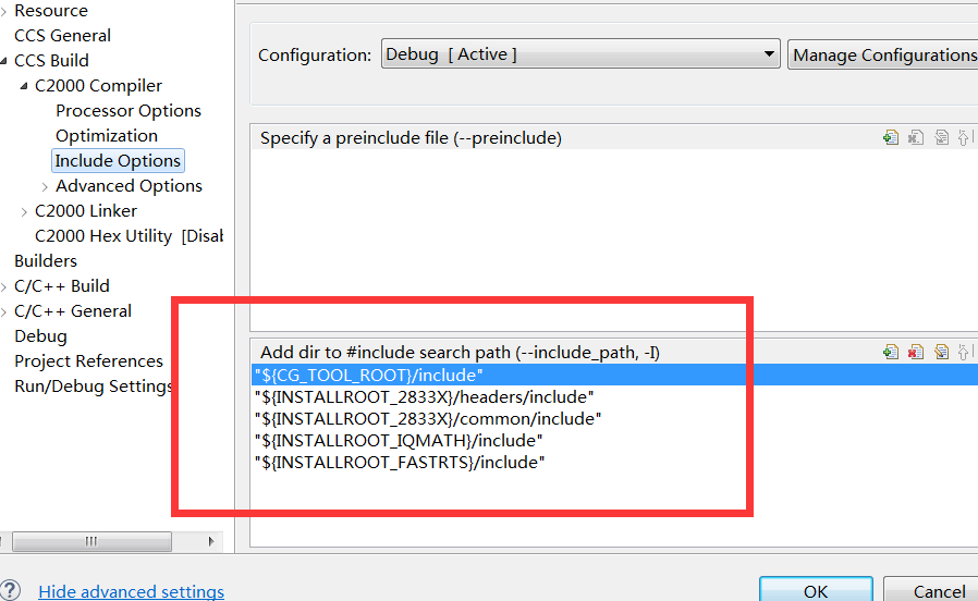

dsp28335编译没有错误,但是无法生成.out文件
**** Build of configuration Debug for project F2833x_DEMO ****
"C:\\ti\\ccsv6\\utils\\bin\\gmake" -k all
'Building file: ../main.c'
'Invoking: C2000 Compiler'
"D:/ti-cgt-c2000_15.12.7.LTS/bin/cl2000" -v28 -ml -mt --float_support=fpu32 -Ooff --include_path="D:/ti-cgt-c2000_15.12.7.LTS/include" --preinclude="D:/ti-cgt-c2000_15.12.7.LTS/include" --preinclude="/DSP2833x_Common/include" --preinclude="/DSP2833x_headers/include" --advice:performance=all -g --undefine="_DEBUG" --undefine="LARGE_MODEL" --display_error_number --diag_warning=225 --diag_wrap=off --preproc_with_compile --preproc_dependency="main.pp"  "../main.c"
Fatal error #1966: cannot open source file "D:/ti-cgt-c2000_15.12.7.LTS/include": Invalid argument
1 catastrophic error detected in the compilation of "../main.c".
Compilation terminated.
>> Compilation failure
gmake: *** [main.obj] Error 1
