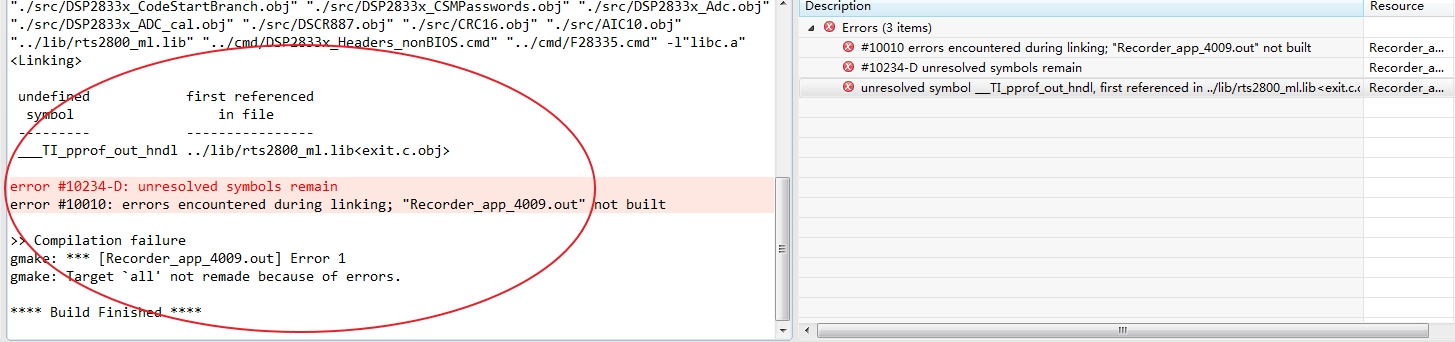

CCS6.0编译工程时,总是报错unresolved symbol——TI_pprof_out_hadl, first referenced in../lib/rts2800_ml.lib
Other Parts Discussed in Thread: TMP121
请问怎么解决这个问题呢

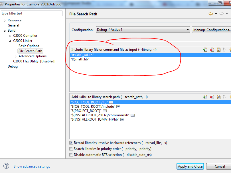

  • 有可能是因为您的RTS2800_ml.lib 在c2000 linker 的路径没有设置好
    您可以参考下
    e2e.ti.com/.../451598
    e2e.ti.com/.../2026951
  • 您好,参考了上面的问题,并没有解决我的问题,请问具体应该这么做呢
  • 请问能否给出console里面详细的编译信息?
    关于路径包含与链接的问题,您可以参考
    processors.wiki.ti.com/.../Include_paths_and_options
  • 下面是console的详细信息
    **** Build of configuration Debug for project Recorder_app_4009 ****
    "c:\\ti\\ccsv6\\utils\\bin\\gmake" -k all
    'Building file: ../src/usb.c'
    'Invoking: C2000 Compiler'
    "c:/ti/ccsv6/tools/compiler/c2000_6.2.5/bin/cl2000" -v28 -ml -mt --float_support=softlib --include_path="c:/ti/ccsv6/tools/compiler/c2000_6.2.5/include" --include_path="C:/Users/lenovo/workspace_v6_0/Recorder_app_4009/include" -g --diag_warning=225 --display_error_number --diag_wrap=off --preproc_with_compile --preproc_dependency="src/usb.pp" --obj_directory="src" "../src/usb.c"
    'Finished building: ../src/usb.c'
    'Building target: Recorder_app_4009.out'
    'Invoking: C2000 Linker'
    "c:/ti/ccsv6/tools/compiler/c2000_6.2.5/bin/cl2000" -v28 -ml -mt --float_support=softlib -g --diag_warning=225 --display_error_number --diag_wrap=off -z -m"Recorder_app_4009.map" --stack_size=0x300 --warn_sections -i"C:/Users/lenovo/workspace_v6_0/Recorder_app_4009/lib" -i"c:/ti/ccsv6/tools/compiler/c2000_6.2.5/lib" -i"c:/ti/ccsv6/tools/compiler/c2000_6.2.5/include" -i"C:/Users/lenovo/workspace_v6_0/Recorder_app_4009" --reread_libs --display_error_number --diag_wrap=off --xml_link_info="Recorder_app_4009_linkInfo.xml" --rom_model -o "Recorder_app_4009.out" "./src/usb.obj" "./src/tmp121.obj" "./src/storage.obj" "./src/queue.obj" "./src/fat.obj" "./src/dtu.obj" "./src/diskio.obj" "./src/ch422.obj" "./src/ch378inc.obj" "./src/cfc.obj" "./src/Xintf.obj" "./src/Update.obj" "./src/SysSWI.obj" "./src/SysInit.obj" "./src/SciSWI.obj" "./src/RecorderMain.obj" "./src/LedCtrl.obj" "./src/EcanRegDoubleRW.obj" "./src/DataProcess.obj" "./src/DSP2833x_usDelay.obj" "./src/DSP2833x_SysCtrl.obj" "./src/DSP2833x_Spi.obj" "./src/DSP2833x_Sci.obj" "./src/DSP2833x_PieVect.obj" "./src/DSP2833x_PieCtrl.obj" "./src/DSP2833x_Mcbsp.obj" "./src/DSP2833x_InitPeripherals.obj" "./src/DSP2833x_Gpio.obj" "./src/DSP2833x_GlobalVariableDefs.obj" "./src/DSP2833x_ECan.obj" "./src/DSP2833x_DefaultIsr.obj" "./src/DSP2833x_DMA.obj" "./src/DSP2833x_CpuTimers.obj" "./src/DSP2833x_CodeStartBranch.obj" "./src/DSP2833x_CSMPasswords.obj" "./src/DSP2833x_Adc.obj" "./src/DSP2833x_ADC_cal.obj" "./src/DSCR887.obj" "./src/CRC16.obj" "./src/AIC10.obj" "../lib/rts2800_ml.lib" "../cmd/DSP2833x_Headers_nonBIOS.cmd" "../cmd/F28335.cmd" -l"libc.a"
    <Linking>
    undefined first referenced
    symbol in file
    ___TI_pprof_out_hndl ../lib/rts2800_ml.lib<exit.c.obj>
    error #10234-D: unresolved symbols remain
    error #10010: errors encountered during linking; "Recorder_app_4009.out" not built
    >> Compilation failure
    gmake: *** [Recorder_app_4009.out] Error 1
    gmake: Target `all' not remade because of errors.
    **** Build Finished ****
  • 请您对照一下您的图示部分是否链接了rts2800_ml.lib?

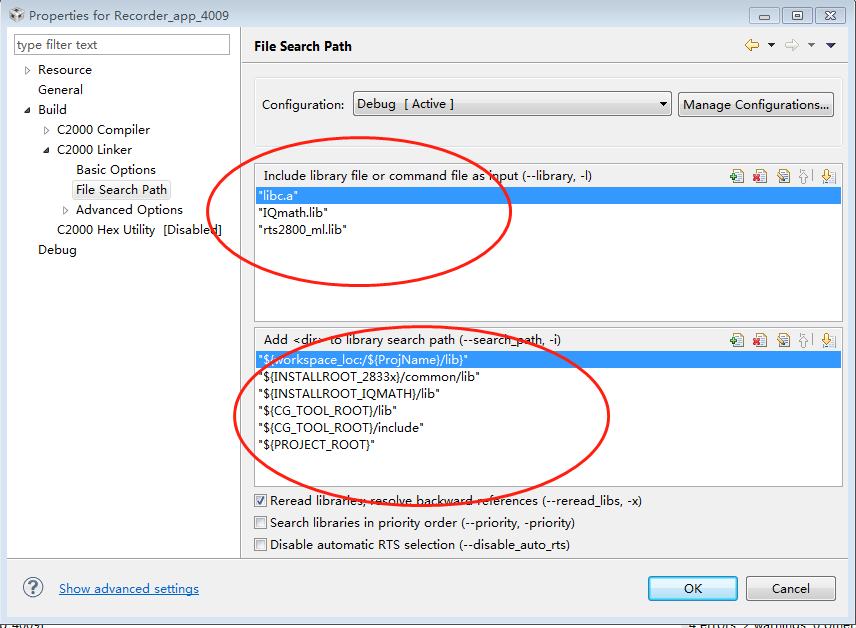

  • 这样配置以后,编译仍然报错
  • 您好,问题已解决,报错是因为使用的rts2800_ml.lib版本与编译器版本不匹配。我的编译器版本是TI v6.2.5,lib库不知道什么版本,重新链接了6.2.5版本的lib库后,编译通过
  • 很高兴您能解决问题
