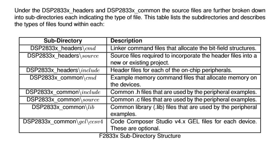

common和headers文件的作用有什么不同,两者下面为什么都有include、source、cmd、gel文件夹?
  • 这个可以在controlSUITE/device_support/f2833x/v142/doc/f2833x-f2823x-FRM-EX-UG.pdf中查找到
    F2833x Main Directory Structure
    <base>\DSP2833x_common
    Common source files shared across example projects to illustrate how to perform tasks using header file approach. Use of these files is optional, but may be useful in new projects.
    <base>\DSP2833x_headers
    Files required to incorporate the peripheral header files into a project.
