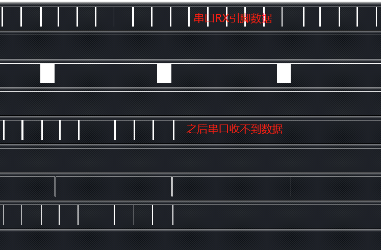

tms320f28379d 串口问题
串口通信帧数据频率 100hz
开机时正常 过一段时间后收不到数据 有时候几秒钟 有时候几分钟 如果把数据不连续发送就能正常工作  请问如何解决

串口异常后的寄存器值
ScibRegs    struct SCI_REGS {...} 0x00007210@Data
    SCICCR     union SCICCR_REG {...} 0x00007210@Data
                 all unsigned int 7 0x00007210@Data
                 bit struct SCICCR_BITS {...} 0x00007210@Data
                       SCICHAR unsigned int : 3 7 0x00007210@Data bit 0-2
                       ADDRIDLE_MODE unsigned int : 1 0 0x00007210@Data bit 3
                       LOOPBKENA unsigned int : 1 0 0x00007210@Data bit 4
                       PARITYENA unsigned int : 1 0 0x00007210@Data bit 5
                       PARITY unsigned int : 1 0 0x00007210@Data bit 6
                       STOPBITS unsigned int : 1 0 0x00007210@Data bit 7
                       rsvd1 unsigned int : 8 0 0x00007210@Data bit 8-15
SCICTL1 union SCICTL1_REG {...} 0x00007211@Data
              all unsigned int 35 0x00007211@Data
              bit struct SCICTL1_BITS {...} 0x00007211@Data
                   RXENA unsigned int : 1 1 0x00007211@Data bit 0
                   TXENA unsigned int : 1 1 0x00007211@Data bit 1
                   SLEEP unsigned int : 1 0 0x00007211@Data bit 2
                   TXWAKE unsigned int : 1 0 0x00007211@Data bit 3
                   rsvd1 unsigned int : 1 0 0x00007211@Data bit 4
                   SWRESET unsigned int : 1 1 0x00007211@Data bit 5
                   RXERRINTENA unsigned int : 1 0 0x00007211@Data bit 6
                   rsvd2 unsigned int : 9 0 0x00007211@Data bit 7-15
                   SCIHBAUD unsigned int 0 0x00007212@Data
                   SCILBAUD unsigned int 6 0x00007213@Data
SCICTL2 union SCICTL2_REG {...} 0x00007214@Data
         all unsigned int 192 0x00007214@Data
         bit struct SCICTL2_BITS {...} 0x00007214@Data
                TXINTENA unsigned int : 1 0 0x00007214@Data bit 0
                RXBKINTENA unsigned int : 1 0 0x00007214@Data bit 1
                rsvd1 unsigned int : 4 0 0x00007214@Data bit 2-5
                TXEMPTY unsigned int : 1 1 0x00007214@Data bit 6
                TXRDY unsigned int : 1 1 0x00007214@Data bit 7
                rsvd2 unsigned int : 8 0 0x00007214@Data bit 8-15
SCIRXST union SCIRXST_REG {...} 0x00007215@Data
        all unsigned int 178 0x00007215@Data
        bit struct SCIRXST_BITS {...} 0x00007215@Data
               rsvd1 unsigned int : 1 0 0x00007215@Data bit 0
               RXWAKE unsigned int : 1 1 0x00007215@Data bit 1
              PE unsigned int : 1 0 0x00007215@Data bit 2
              OE unsigned int : 1 0 0x00007215@Data bit 3
              FE unsigned int : 1 1 0x00007215@Data bit 4
              BRKDT unsigned int : 1 1 0x00007215@Data bit 5
              RXRDY unsigned int : 1 0 0x00007215@Data bit 6
              RXERROR unsigned int : 1 1 0x00007215@Data bit 7
              rsvd2 unsigned int : 8 0 0x00007215@Data bit 8-15
       SCIRXEMU unsigned int 35 0x00007216@Data
SCIRXBUF union SCIRXBUF_REG {...} 0x00007217@Data
       all unsigned int 63 0x00007217@Data
       bit struct SCIRXBUF_BITS {...} 0x00007217@Data
                RXDT unsigned int : 8 63 0x00007217@Data bit 0-7
                rsvd1 unsigned int : 6 0 0x00007217@Data bit 8-13
                SCIFFPE unsigned int : 1 0 0x00007217@Data bit 14
                 SCIFFFE unsigned int : 1 0 0x00007217@Data bit 15
                rsvd1 unsigned int 0 0x00007218@Data
                SCITXBUF unsigned int 136 0x00007219@Data
SCIFFTX union SCIFFTX_REG {...} 0x0000721A@Data
          all unsigned int 57505 0x0000721A@Data
          bit struct SCIFFTX_BITS {...} 0x0000721A@Data
                TXFFIL unsigned int : 5 1 0x0000721A@Data bit 0-4
                TXFFIENA unsigned int : 1 1 0x0000721A@Data bit 5
                TXFFINTCLR unsigned int : 1 0 0x0000721A@Data bit 6
                 TXFFINT unsigned int : 1 1 0x0000721A@Data bit 7
                TXFFST unsigned int : 5 0 0x0000721A@Data bit 8-12
                TXFIFOXRESET unsigned int : 1 1 0x0000721A@Data bit 13
                SCIFFENA unsigned int : 1 1 0x0000721A@Data bit 14
                 SCIRST unsigned int : 1 1 0x0000721A@Data bit 15
SCIFFRX union SCIFFRX_REG {...} 0x0000721B@Data
       all unsigned int 8225 0x0000721B@Data
       bit struct SCIFFRX_BITS {...} 0x0000721B@Data
            RXFFIL unsigned int : 5 1 0x0000721B@Data bit 0-4
            RXFFIENA unsigned int : 1 1 0x0000721B@Data bit 5
            RXFFINTCLR unsigned int : 1 0 0x0000721B@Data bit 6
            RXFFINT unsigned int : 1 0 0x0000721B@Data bit 7
            RXFFST unsigned int : 5 0 0x0000721B@Data bit 8-12
            RXFIFORESET unsigned int : 1 1 0x0000721B@Data bit 13
            RXFFOVRCLR unsigned int : 1 0 0x0000721B@Data bit 14
            RXFFOVF unsigned int : 1 0 0x0000721B@Data bit 15
SCIFFCT union SCIFFCT_REG {...} 0x0000721C@Data
       all unsigned int 0 0x0000721C@Data
       bit struct SCIFFCT_BITS {...} 0x0000721C@Data
              FFTXDLY unsigned int : 8 0 0x0000721C@Data bit 0-7
              rsvd1 unsigned int : 5 0 0x0000721C@Data bit 8-12
              CDC unsigned int : 1 0 0x0000721C@Data bit 13
              ABDCLR unsigned int : 1 0 0x0000721C@Data bit 14
              ABD unsigned int : 1 0 0x0000721C@Data bit 15
              rsvd2 unsigned int 0 0x0000721D@Data
              rsvd3 unsigned int 0 0x0000721E@Data
SCIPRI union SCIPRI_REG {...} 0x0000721F@Data
      all unsigned int 0 0x0000721F@Data
      bit struct SCIPRI_BITS {...} 0x0000721F@Data
            rsvd1 unsigned int : 3 0 0x0000721F@Data bit 0-2
            FREE unsigned int : 1 0 0x0000721F@Data bit 3
            SOFT unsigned int : 1 0 0x0000721F@Data bit 4
            rsvd2 unsigned int : 3 0 0x0000721F@Data bit 5-7
            rsvd3 unsigned int : 8 0 0x0000721F@Data bit 8-15

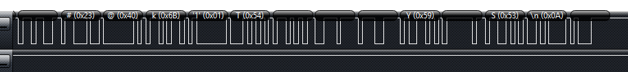

连续发生数据
数据间隔发送
