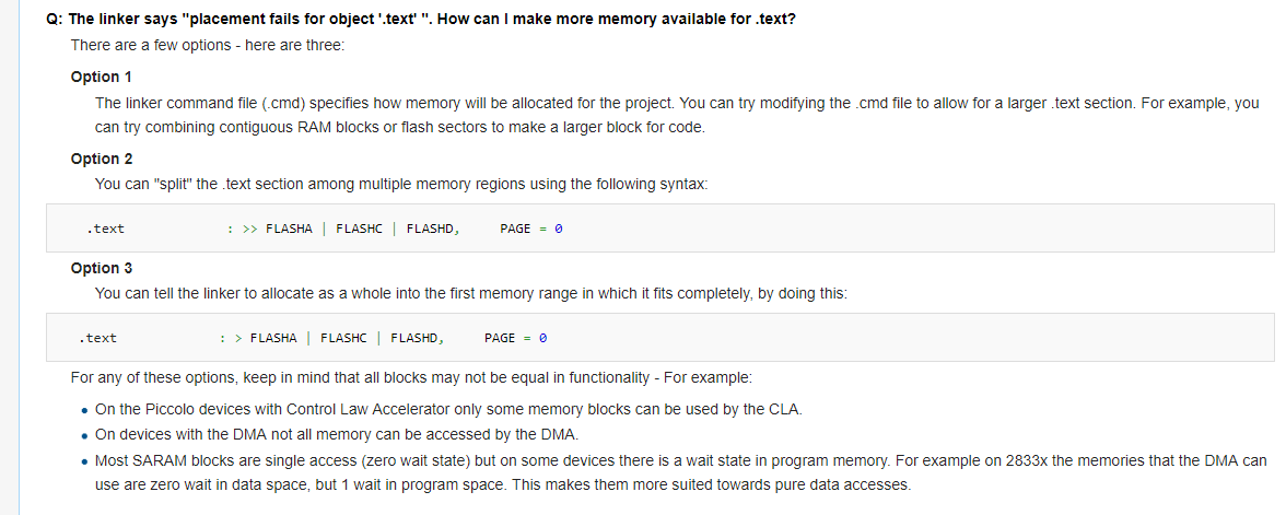

"E:\\CCS\\CCS3workplace\\BLDC2\\CMD\\F2812_EzDSP_RAM_lnk.cmd", line 101: error:
   placement fails for object ".text", size 0x16bb (page 0).  Available ranges:
   PRAMH0       size: 0x14fe       unused: 0x1218       max hole: 0x1218
error: errors encountered during linking; "./Debug/Work.out" not built
>> Compilation failure
Build Complete,
  2 Errors, 0 Warnings, 0 Remarks.
如上,大佬们这是错在哪儿了,本来好好的,我加了两个数组来查表后就编程这样了
