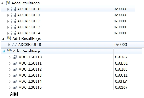

我想在运行过程中反复切换ADC采样的触发源,配置的原理是这样的:
SOCA和AOCB分别用EPWM1的COMPB减计数和增计数相等时触发,COPMB配置为影子模式,周期和下溢点更新,在增计数时用SOCB触发ADCA,ADCB和ADCC三个模块采样,减计数时用SOCA触发ADCA,ADCB和ADCC三个模块采样,在周期和下溢都执行的PWM中断中改变COMPB的值和触发方式。PWM模块增减计数,使能周期和下溢中断.
现在问题是,ADCC模块一直在采样,ADCA和ADCB模块不采样。下面是我的配置,请帮忙查看。谢谢。
配置代码

    // Set SOC5 to set the interrupt 1 flag. Enable the interrupt and make sure its flag is cleared.
    ADC_setInterruptSource(ADCC_BASE, ADC_INT_NUMBER1, ADC_SOC_NUMBER5);
    ADC_enableInterrupt(ADCC_BASE, ADC_INT_NUMBER1);
    ADC_clearInterruptStatus(ADCC_BASE, ADC_INT_NUMBER1);
