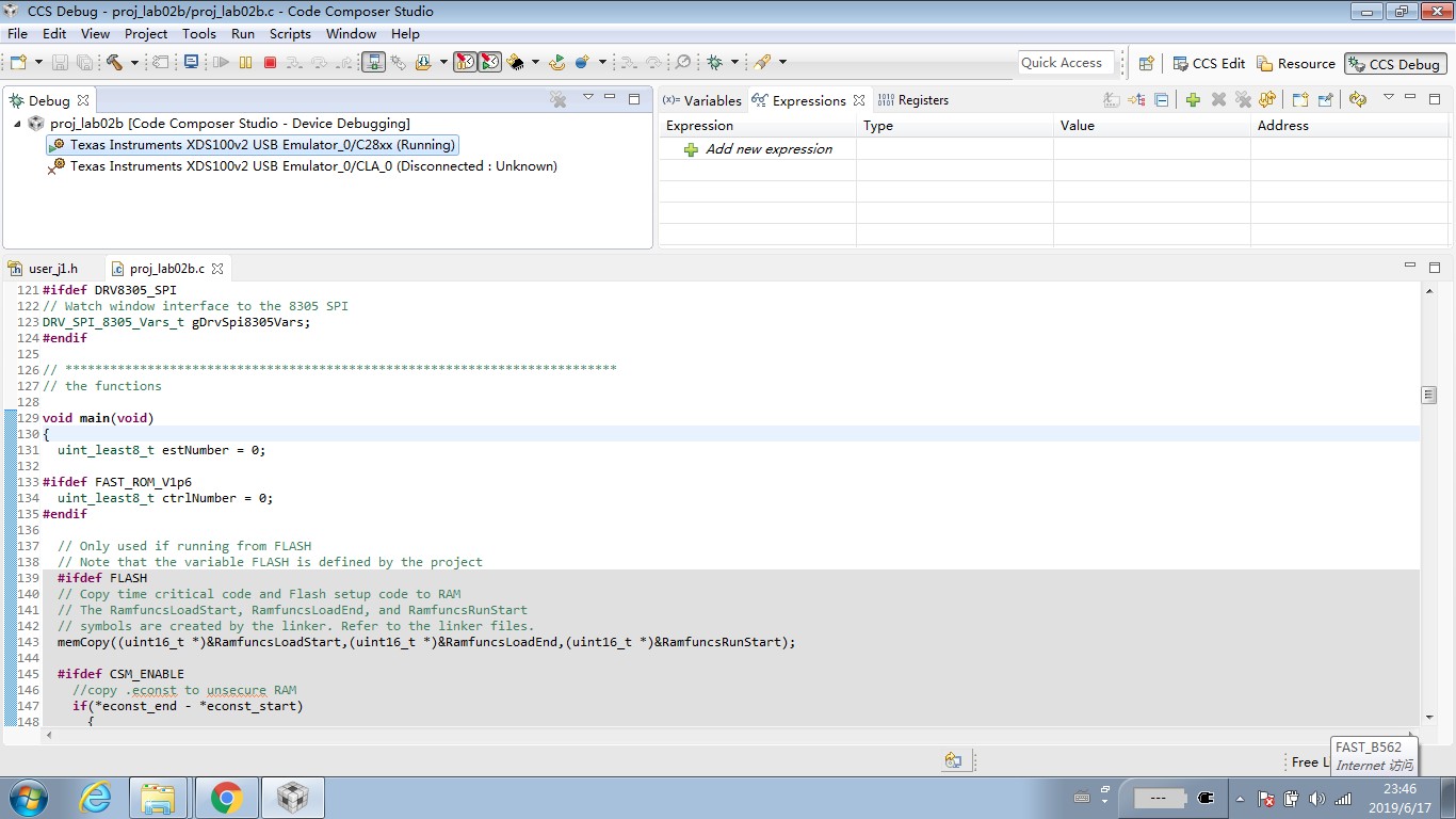

Select the scripting tool, from the debugger menu “View->Scripting Console”.
The scripting console window will appear somewhere in the debugger.
Open the script by clicking the icon that is in the upper right corner of the scripting tool.
Select the file “sw\solutions\instaspin_foc\src\proj_lab02a.js”.
The appropriate motor variables are now automatically populated into the watch window.
The variables should look like below
