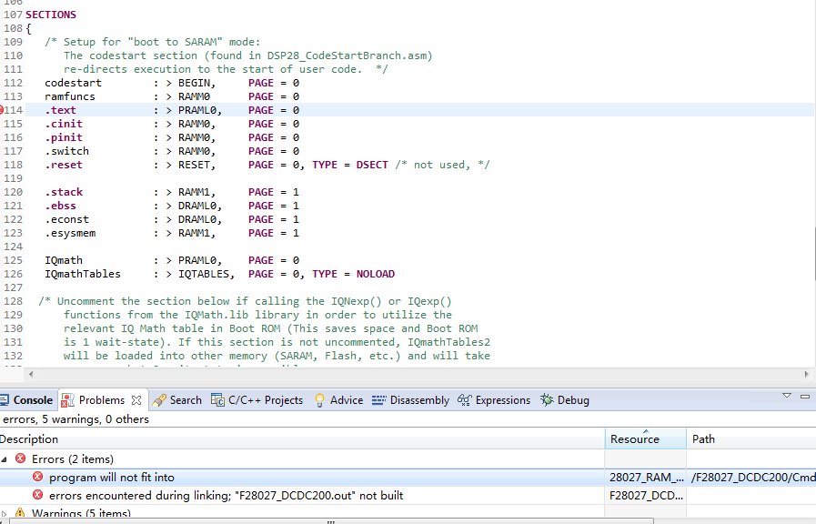

ram编译问题
F28027_RAM.cmd,编译会出现如下错误,flash.cmd编译无错。

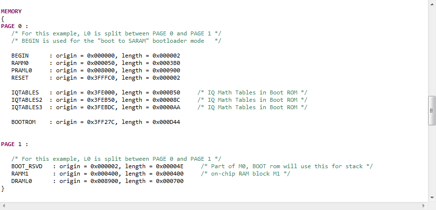

有尝试将
 PRAML0     : origin = 0x008000, length = 0x000900
DRAML0      : origin = 0x008900, length = 0x000700
改为
PRAML0     : origin = 0x008000, length = 0x001000
DRAML0      : origin = 0x009000, length = 0x000600
F28027_RAM.cmd编译无错,但是debug模式中断不在响应,求指教!!先谢谢了
