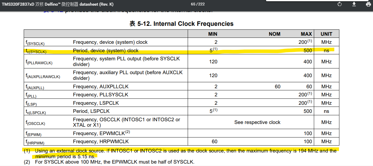

您可以Configure PRDH: PRD to the time duration you want which will be multiple of the base period of the System clock. You can also pre-scale the System clock using TDDRH:TDDR.
