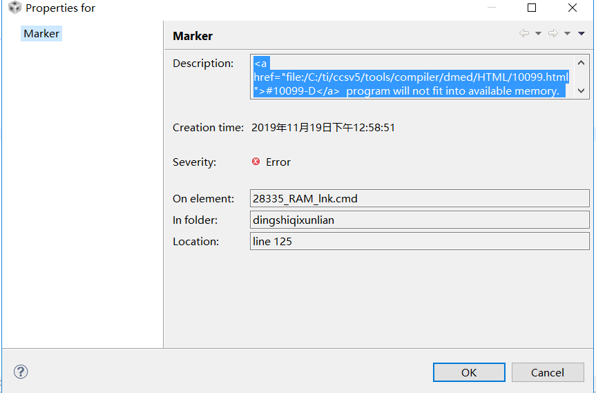

我是个新手,使用CCS5.5编译出现了点问题,不知道要怎么搞
<a href="file:/C:/ti/ccsv5/tools/compiler/dmed/HTML/10099.html">#10099-D</a>  program will not fit into available memory
  • 请您详细说明下您的信息。您现在使用的板子以及程序是什么?
  • 28335,程序就是一个简单的定时器试验

  • 我试了一下并没有出现错误(新建工程测试)
    请您右键点击错误 选择 properties 看一下具体是什么错误
  • 就是这个样子的,麻烦看一下
  • 试一下下面的link cmd文件

       /* corrupting this area during the debug process              */
       BOOT_RSVD  : origin = 0x000002, length = 0x00004E     /* Part of M0, BOOT rom will use this for stack */
       RAMM1      : origin = 0x000400, length = 0x000400     /* on-chip RAM block M1 */
       RAML4      : origin = 0x00C000, length = 0x001000
       RAML5      : origin = 0x00D000, length = 0x001000
       RAML6      : origin = 0x00E000, length = 0x001000
       RAML7      : origin = 0x00F000, length = 0x001000
       ZONE7B     : origin = 0x20FC00, length = 0x000400     /* XINTF zone 7 - data space */
    SECTIONS
       /* Setup for "boot to SARAM" mode:
          The codestart section (found in DSP28_CodeStartBranch.asm)
          re-directs execution to the start of user code.  */
       codestart        : > BEGIN,     PAGE = 0
    #ifdef __TI_COMPILER_VERSION__
       #if __TI_COMPILER_VERSION__ >= 15009000
        .TI.ramfunc : {} > RAML0,      PAGE = 0
       #else
       ramfuncs         : > RAML0,     PAGE = 0
       #endif
    #endif
       .text            : > RAML1,     PAGE = 0
       .cinit           : > RAML0,     PAGE = 0
       .pinit           : > RAML0,     PAGE = 0
       .switch          : > RAML0,     PAGE = 0
       .stack           : > RAMM1,     PAGE = 1
       .ebss            : > RAML4,     PAGE = 1
       .econst          : > RAML5,     PAGE = 1
       .esysmem         : > RAMM1,     PAGE = 1
       IQmath           : > RAML1,     PAGE = 0
       IQmathTables     : > IQTABLES,  PAGE = 0, TYPE = NOLOAD
       /* Uncomment the section below if calling the IQNexp() or IQexp()
          functions from the IQMath.lib library in order to utilize the
          relevant IQ Math table in Boot ROM (This saves space and Boot ROM
          is 1 wait-state). If this section is not uncommented, IQmathTables2
          will be loaded into other memory (SARAM, Flash, etc.) and will take
          up space, but 0 wait-state is possible.
       IQmathTables2    : > IQTABLES2, PAGE = 0, TYPE = NOLOAD
                  IQmath.lib<IQNexpTable.obj> (IQmathTablesRam)
       FPUmathTables    : > FPUTABLES, PAGE = 0, TYPE = NOLOAD
       DMARAML4         : > RAML4,     PAGE = 1
       DMARAML5         : > RAML5,     PAGE = 1
       DMARAML6         : > RAML6,     PAGE = 1
       DMARAML7         : > RAML7,     PAGE = 1
       ZONE7DATA        : > ZONE7B,    PAGE = 1
       .reset           : > RESET,     PAGE = 0, TYPE = DSECT /* not used                    */
       csm_rsvd         : > CSM_RSVD   PAGE = 0, TYPE = DSECT /* not used for SARAM examples */
       csmpasswds       : > CSM_PWL    PAGE = 0, TYPE = DSECT /* not used for SARAM examples */
       /* Allocate ADC_cal function (pre-programmed by factory into TI reserved memory) */
       .adc_cal     : load = ADC_CAL,   PAGE = 0, TYPE = NOLOAD
    // End of file.
