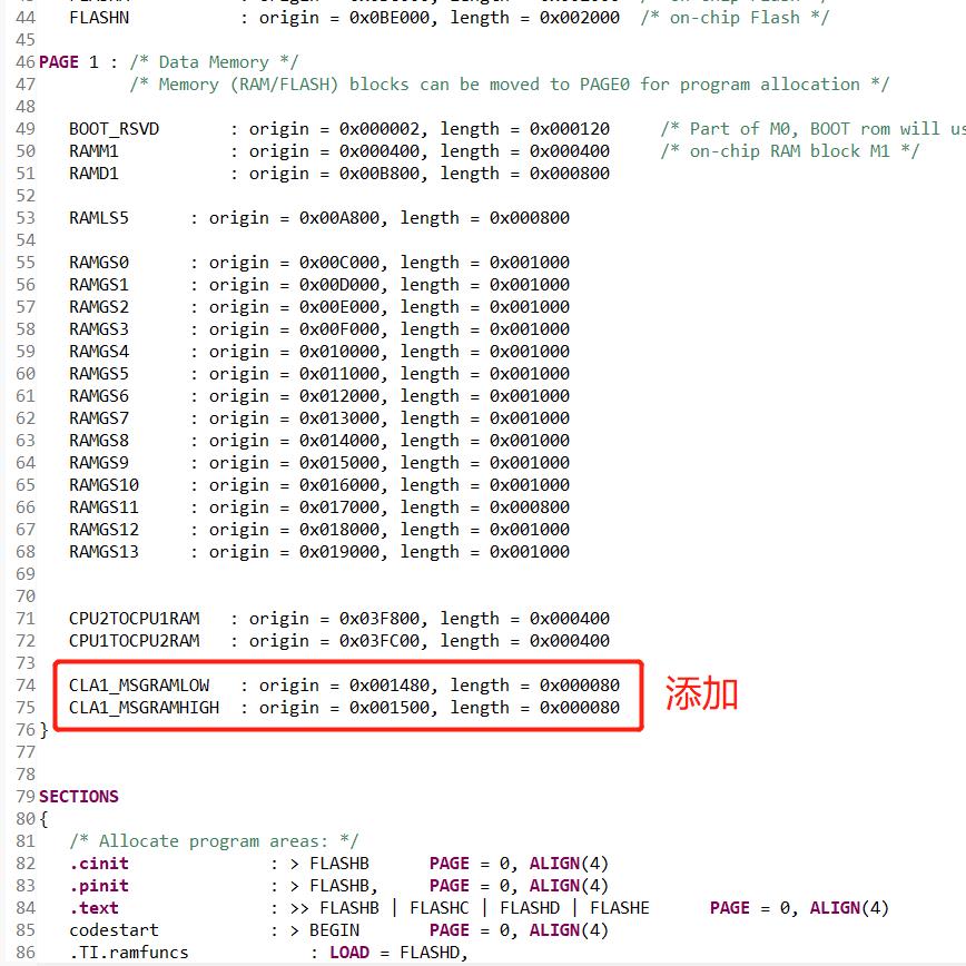

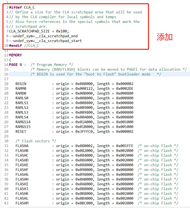

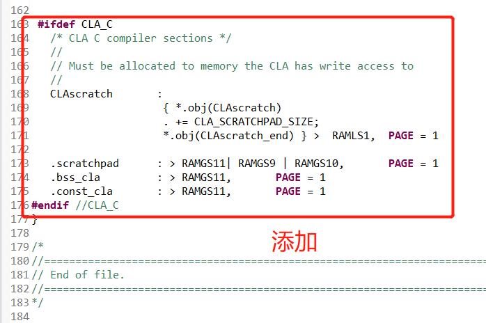

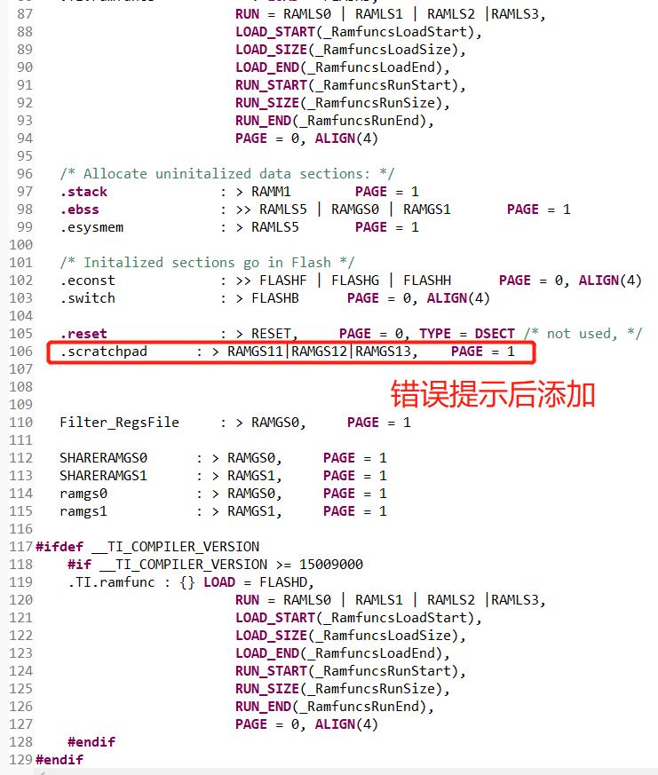

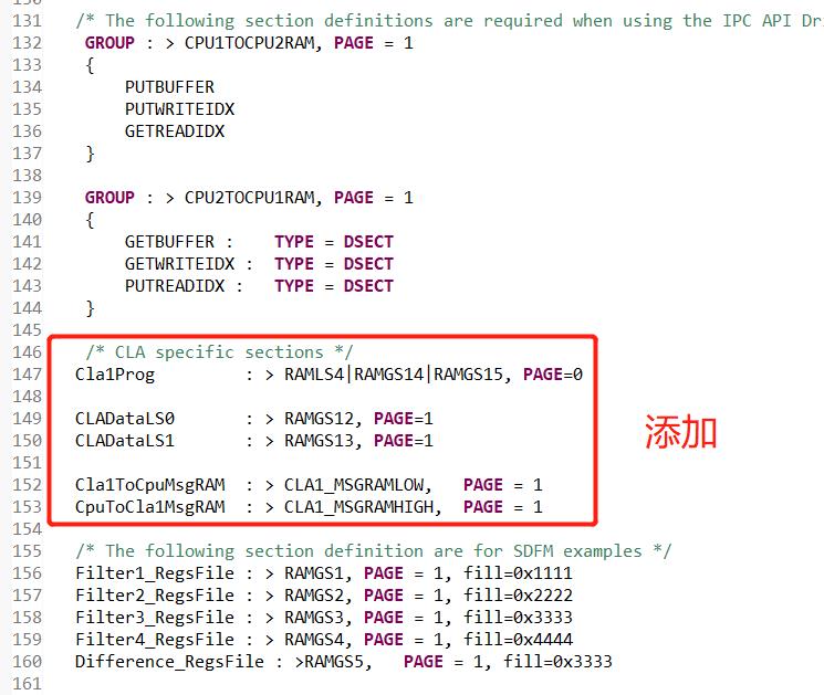

例程里的2837xD_FLASH_lnk_cpu1.cmd改动加入CLA specific sections和CLA C compiler sections后出现警告17003-D怎么解决?

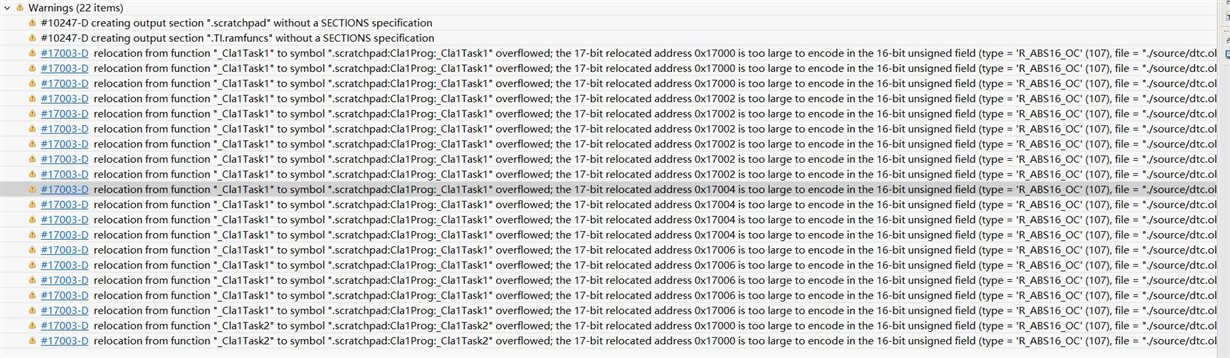

Description Resource Path Location Type
<a href="file:/D:/software/TI/ccs/ccsv6/tools/compiler/dmed/HTML/17003.html">#17003-D</a> /home/a0132186/c2000_repo/c2000ware/libraries/math/temp/source/CLAdiv.asm relocation from assembly function "_CLAdiv" to symbol ".scratchpad:Cla1Prog:_CLAdiv" overflowed; the 17-bit relocated address 0x17008 is too large to encode in the 16-bit unsigned field (type = 'R_ABS16_OC' (107), file = "../Lib/cla0_math_library_datarom_fpu32.lib<CLAdiv.obj>", offset = 0x00000000, section = "Cla1Prog:_CLAdiv") DTC_test_5 line 53 C/C++ Problem
<a href="file:/D:/software/TI/ccs/ccsv6/tools/compiler/dmed/HTML/17003.html">#17003-D</a> relocation from function "_Cla1Task1" to symbol ".scratchpad:Cla1Prog:_Cla1Task1" overflowed; the 17-bit relocated address 0x17000 is too large to encode in the 16-bit unsigned field (type = 'R_ABS16_OC' (107), file = "./source/dtc.obj", offset = 0x00000014, section = "Cla1Prog:_Cla1Task1") dtc.cla /DTC_test_5/source line 111 C/C++ Problem
<a href="file:/D:/software/TI/ccs/ccsv6/tools/compiler/dmed/HTML/17003.html">#17003-D</a> relocation from function "_Cla1Task2" to symbol ".scratchpad:Cla1Prog:_Cla1Task2" overflowed; the 17-bit relocated address 0x17000 is too large to encode in the 16-bit unsigned field (type = 'R_ABS16_OC' (107), file = "./source/dtc.obj", offset = 0x000000e0, section = "Cla1Prog:_Cla1Task2") dtc.cla /DTC_test_5/source line 197 C/C++ Problem
