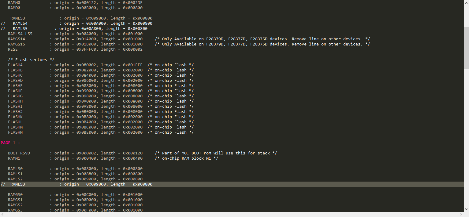

我把RAMLS3从page1移动到page0.然后把运行程序从RAMLS4移动到RAMLS3中可以么?

  • 主要原因是cla的程序超过1K,我就把原来cpu程序段RAM—LS4与LS5合并到一起给CLA用了。现在仿真的时候cla不运行了。。。

    MEMORY
    PAGE 0 :
       /* BEGIN is used for the "boot to SARAM" bootloader mode   */
       BEGIN           	: origin = 0x080000, length = 0x000002
       RAMM0           	: origin = 0x000122, length = 0x0002DE
       RAMD0           	: origin = 0x00B000, length = 0x000800
    	RAMLS3      		: origin = 0x009800, length = 0x000800
    //   RAMLS4      	    : origin = 0x00A000, length = 0x000800
    //   RAMLS5           : origin = 0x00A800, length = 0x000800
       RAMLS4_LS5     	: origin = 0x00A000, length = 0x001000
       RAMGS14          : origin = 0x01A000, length = 0x001000     /* Only Available on F28379D, F28377D, F28375D devices. Remove line on other devices. */
       RAMGS15          : origin = 0x01B000, length = 0x001000     /* Only Available on F28379D, F28377D, F28375D devices. Remove line on other devices. */
       RESET           	: origin = 0x3FFFC0, length = 0x000002
       /* Flash sectors */
       FLASHA           : origin = 0x080002, length = 0x001FFE	/* on-chip Flash */
       FLASHB           : origin = 0x082000, length = 0x002000	/* on-chip Flash */
       FLASHC           : origin = 0x084000, length = 0x002000	/* on-chip Flash */
       FLASHD           : origin = 0x086000, length = 0x002000	/* on-chip Flash */
       FLASHE           : origin = 0x088000, length = 0x008000	/* on-chip Flash */
       FLASHF           : origin = 0x090000, length = 0x008000	/* on-chip Flash */
       FLASHG           : origin = 0x098000, length = 0x008000	/* on-chip Flash */
       FLASHH           : origin = 0x0A0000, length = 0x008000	/* on-chip Flash */
       FLASHI           : origin = 0x0A8000, length = 0x008000	/* on-chip Flash */
       FLASHJ           : origin = 0x0B0000, length = 0x008000	/* on-chip Flash */
       FLASHK           : origin = 0x0B8000, length = 0x002000	/* on-chip Flash */
       FLASHL           : origin = 0x0BA000, length = 0x002000	/* on-chip Flash */
       FLASHM           : origin = 0x0BC000, length = 0x002000	/* on-chip Flash */
       FLASHN           : origin = 0x0BE000, length = 0x002000	/* on-chip Flash */
    PAGE 1 :
       BOOT_RSVD        : origin = 0x000002, length = 0x000120     /* Part of M0, BOOT rom will use this for stack */
       RAMM1            : origin = 0x000400, length = 0x000400     /* on-chip RAM block M1 */
       RAMLS0          	: origin = 0x008000, length = 0x000800
       RAMLS1          	: origin = 0x008800, length = 0x000800
       RAMLS2      		: origin = 0x009000, length = 0x000800
    //	RAMLS3      		: origin = 0x009800, length = 0x000800

  • “把原来cpu程序段RAM—LS4与LS5合并到一起给CLA用了”
    这个是可以的,您可以使用下面的语句
    Cla1Prog :>> RAMSLS5 | RAMLS4, PAGE=0
    或者
    MEMORY
    PAGE 0 :
    RAMLS45 : origin = 0x00A000, length = 0x001000
    PAGE 1 :
    SECTIONS
    Cla1Prog : LOAD = FLASHD,
    RUN = RAMLS45,
    RUN_START(_Cla1funcsRunStart),
    LOAD_START(_Cla1funcsLoadStart),
    LOAD_SIZE(_Cla1funcsLoadSize),
    PAGE = 0
    另外有一些网友分享的经验,您可以参考一下
    blog.csdn.net/.../78995125
