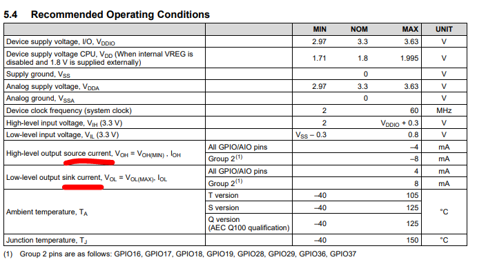

DSPTMS320F28035-ePWM1~6 source current/sink current

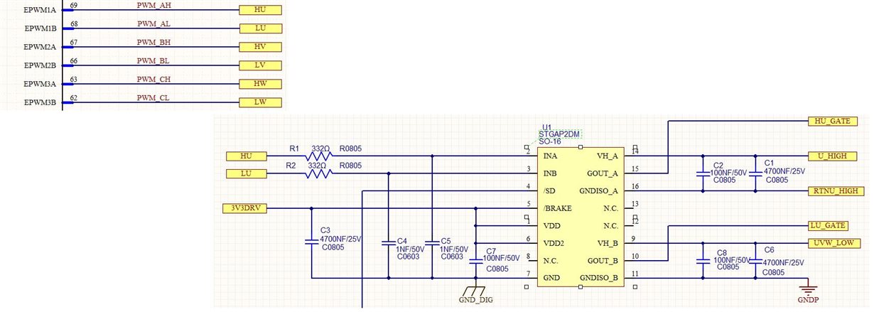

Dear team,
下图是f28035的输出,提供小信号给隔离驱动IC(右图),通过隔离驱动IC来驱动功率晶体。
问题是这6只输出脚的source current/sink current分别是多少?
Thank you.
