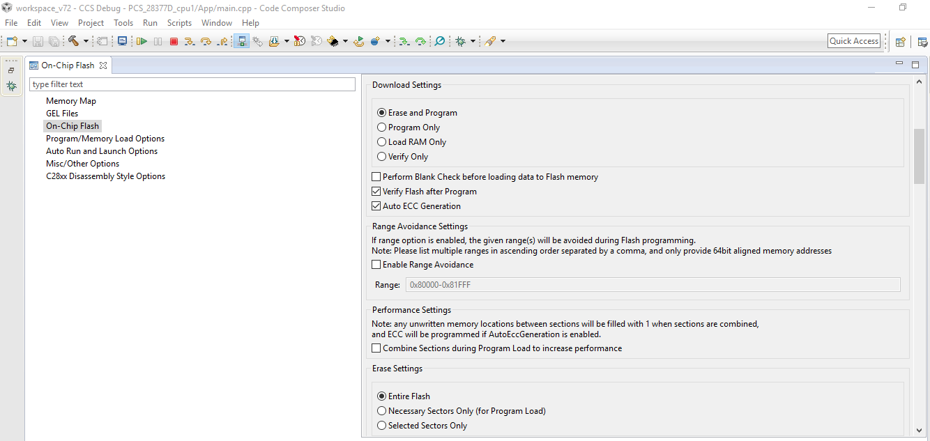

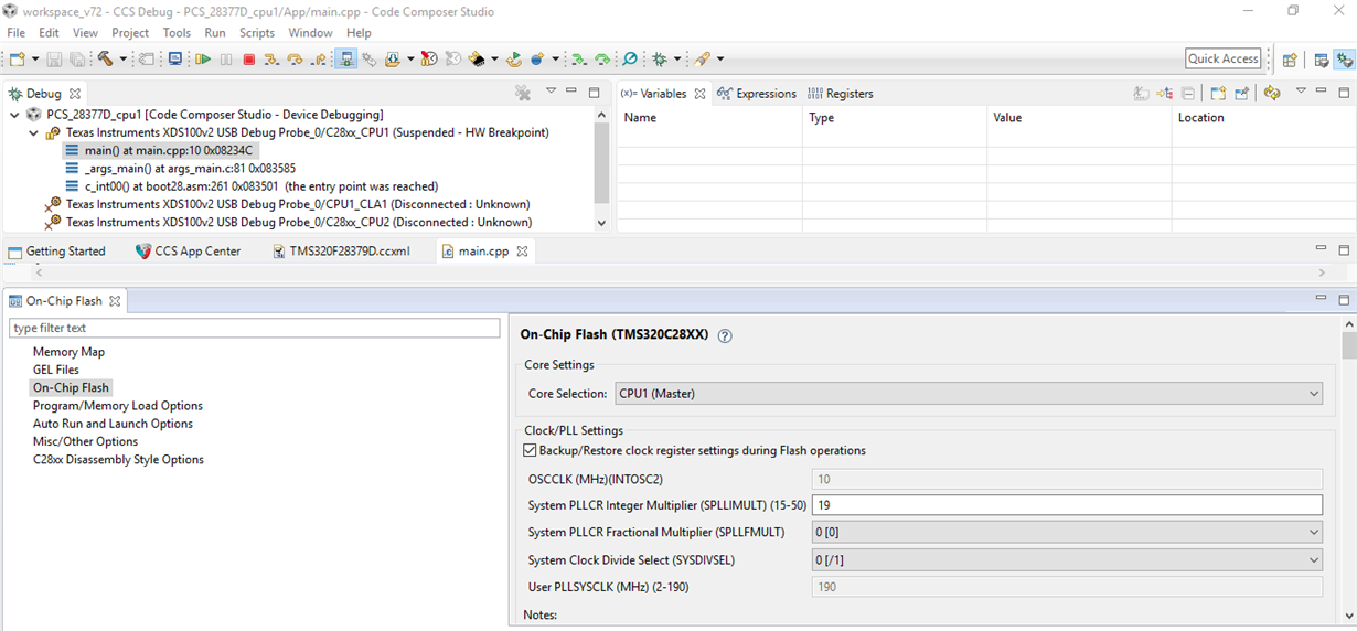

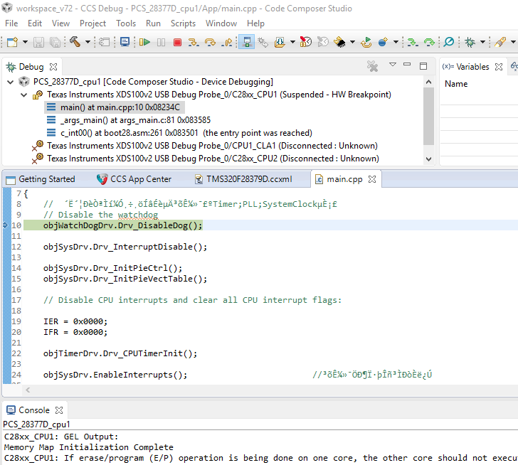

28379D程序烧录失败
Other Parts Discussed in Thread: C2000WARE, UNIFLASH
C28xx_CPU1: GEL Output:
Memory Map Initialization Complete
C28xx_CPU1: Loader: One or more sections of your program falls into a memory region that is not writable. These regions will not actually be written to the target. Check your linker configuration and/or memory map.
C28xx_CPU1: File Loader: Verification failed: Values at address 0x8201C@Program do not match Please verify target memory and memory map.
C28xx_CPU1: GEL: File: F:\DSP_28377\28377D_Code\ti\PCS_28377D_cpu1\CPU1_FLASH_DEBUG\PCS_28377D_cpu1.out: a data verification error occurred, file load failed.
使用仿真器为XDS100V3
CCS版本为7.2.0
