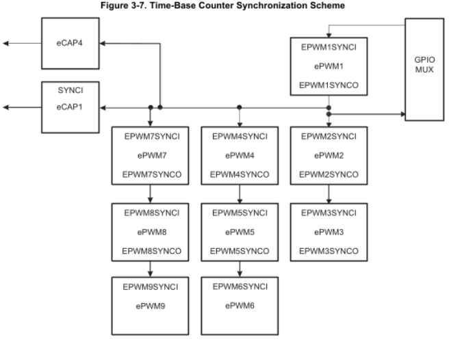

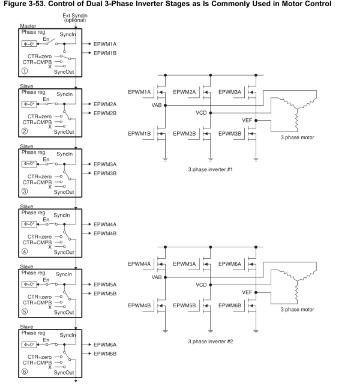

Is the EPWM4SYNCI connected to EPWM1SYNCO or EPWM3SYNCO?
In  Figure 3-7 (page 232 of TMS320x2833x Technical Reference Manual ), it seems that EPWM4SYNCI is connected to EPWM1SYNCO.
But in Figure 3-53 (page 285 of TMS320x2833xTechnical Reference Manual ), it seems that EPWM4SYNCI is connected to EPWM3SYNCO.
These two explanations are very confusing. Is there any specific explanation about EPWMxSYNCI and EPWMxSYNCO?
EPWM4SYNCI 端口是连接 EPWM1SYNCO 还是 EPWM3SYNCO?
TMS320x2833x Technical Reference Manual 的232页,图3-7可以看出,EPWM4SYNCI 端口是连接 EPWM1SYNCO的,
但是TMS320x2833x Technical Reference Manual 的285页,图3-53可以看出,EPWM4SYNCI 端口是连接 EPWM3SYNCO的.
这两处表述令人很困惑,请问各个模块的SYNCI和SYNCO到底是什么链接和配置方式?
