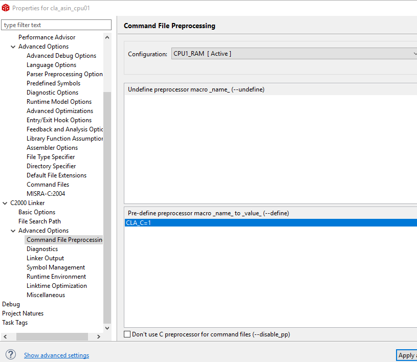

TMS320F28379D CLA CMD CLA_C
#ifdef CLA_C
// Define a size for the CLA scratchpad area that will be used
// by the CLA compiler for local symbols and temps
// Also force references to the special symbols that mark the
// scratchpad are.
CLA_SCRATCHPAD_SIZE = 0x200;
--undef_sym=__cla_scratchpad_end
--undef_sym=__cla_scratchpad_start
#endif //CLA_C
这个CLA_C在哪定义的?
