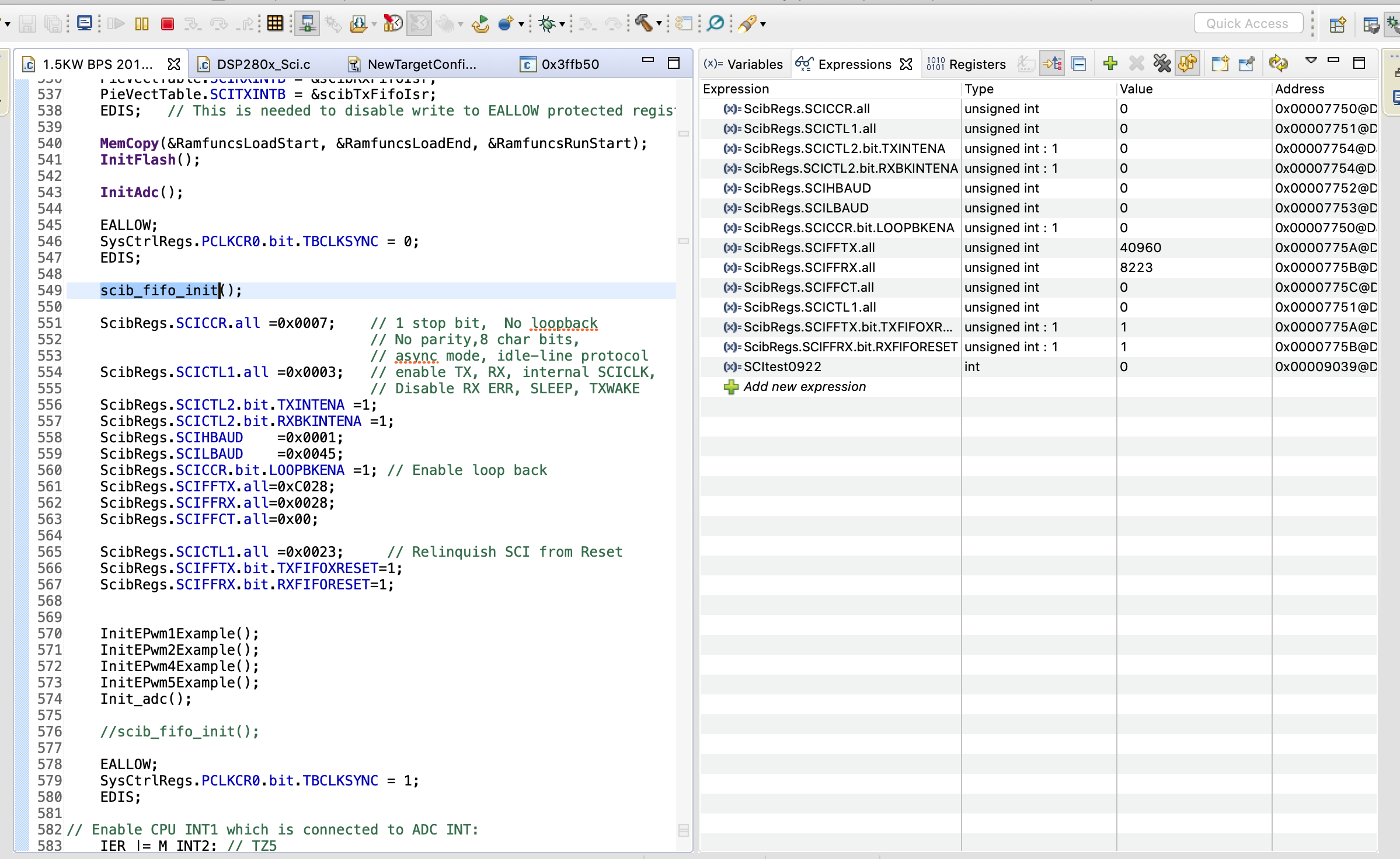

2808 SCI 暫存器設定不會更新
暫存器設定如下:
    ScibRegs.SCICCR.all =0x0007;    // 1 stop bit,  No loopback
                                    // No parity,8 char bits,
                                    // async mode, idle-line protocol
    ScibRegs.SCICTL1.all =0x0003;   // enable TX, RX, internal SCICLK,
                                    // Disable RX ERR, SLEEP, TXWAKE
    ScibRegs.SCICTL2.bit.TXINTENA =1;
    ScibRegs.SCICTL2.bit.RXBKINTENA =1;
    ScibRegs.SCIHBAUD    =0x0001;
    ScibRegs.SCILBAUD    =0x0045;
    ScibRegs.SCICCR.bit.LOOPBKENA =1; // Enable loop back
    ScibRegs.SCIFFTX.all=0xC028;
    ScibRegs.SCIFFRX.all=0x0028;
    ScibRegs.SCIFFCT.all=0x00;
    ScibRegs.SCICTL1.all =0x0023;     // Relinquish SCI from Reset
    ScibRegs.SCIFFTX.bit.TXFIFOXRESET=1;
    ScibRegs.SCIFFRX.bit.RXFIFORESET=1;
但是當我進入debug 模式下使用,觀看registers卻沒有看到有如我的設定一樣
請問是還需要做哪些設定嗎?
不太懂SCI的設定,好像沒有很直觀?
