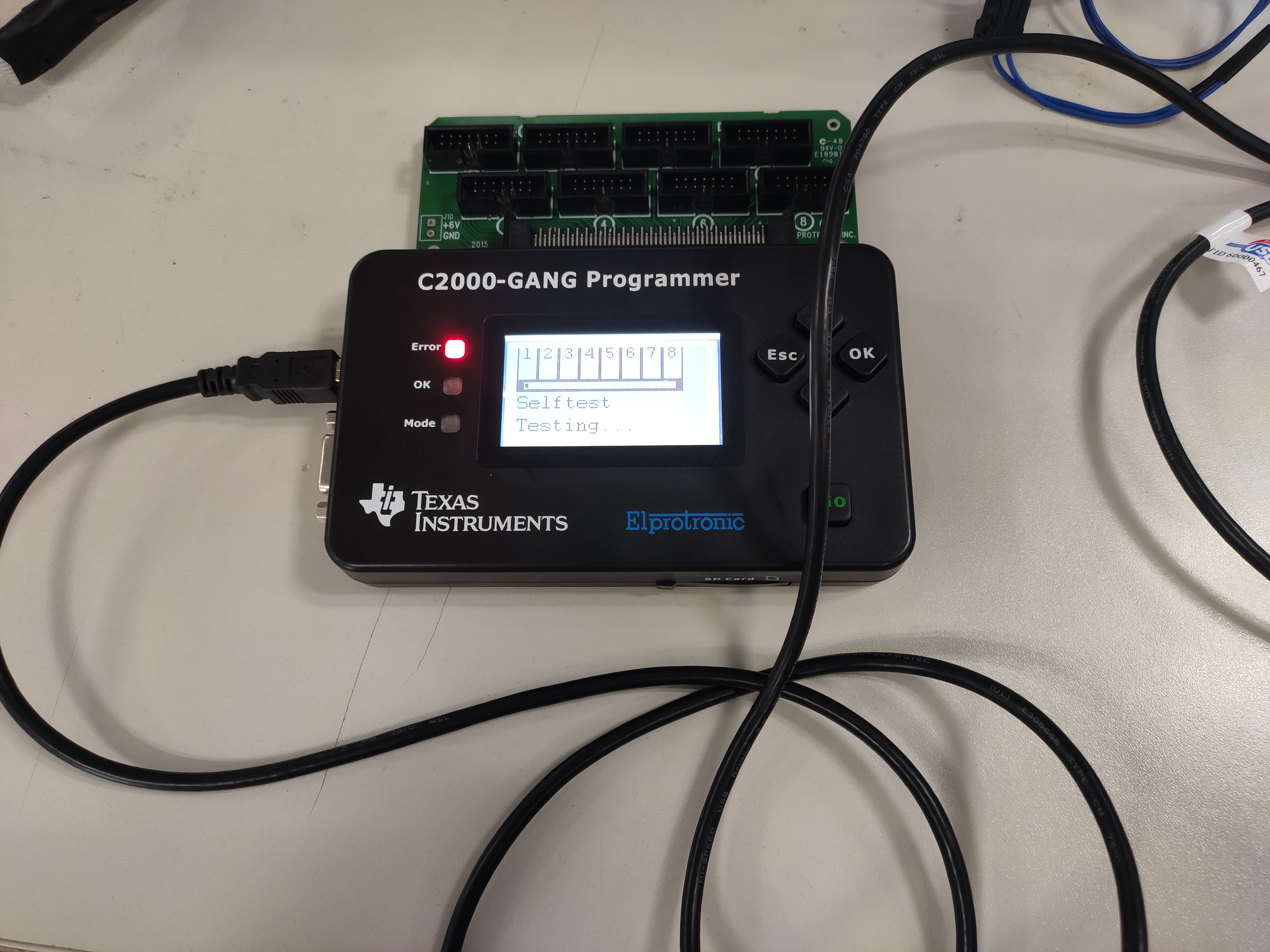

新买的C2000-GANG,安装从TI官网下载C2000-GANG-1V046-Setup.zip后,打开C2000-GANG软件,并将设备通过USB连接到笔记本电脑。弹出如下对话框:
显示离线烧录器内的固件版本为01.01.01.00,而官网下载的C2000-GANG软件版本为:01.00.04.06,点击“确定”后,离线烧录器内固件被刷为01.00.04.06。
执行Copy file to Image后,无法存储程序,显示如下第2图:
  • selftest报告如下:
    === C2000-GANG Self test results ( Thursday, November 19, 2020, 09:14:12 ) ===
    Adapter SN ------: 19110075
    Hardware --------: C2K : 01.04
    Access key ------: C2000 - Gang Programmer
    Silicon Number --: CE36 B46F 2E00 0C00
    API Firmware ----: C2K-Gang AC28: 01.00.04.06
    BOOT Firmware ---: G430BOOT B430: 01.00.02.00
    GUI Software ----: C2000-Gang-GUI G28x: 01.00.04.06
    DLL Software ----: C2000-Gang-DLL D280: 01.00.04.06
    ================ Test results =============

    34: Vcc Target-1 (ALL ON 3.3V) 3.30 V ( 3.10 to 3.50) Result: 0.13 V ... >> ERROR <<
    35: Vcc Target-2 (ALL ON 3.3V) 3.30 V ( 3.10 to 3.50) Result: 0.12 V ... >> ERROR <<
    36: Vcc Target-3 (ALL ON 3.3V) 3.30 V ( 3.10 to 3.50) Result: 0.12 V ... >> ERROR <<
    37: Vcc Target-4 (ALL ON 3.3V) 3.30 V ( 3.10 to 3.50) Result: 0.12 V ... >> ERROR <<
    38: Vcc Target-5 (ALL ON 3.3V) 3.30 V ( 3.10 to 3.50) Result: 0.12 V ... >> ERROR <<
    39: Vcc Target-6 (ALL ON 3.3V) 3.30 V ( 3.10 to 3.50) Result: 0.12 V ... >> ERROR <<
    40: Vcc Target-7 (ALL ON 3.3V) 3.30 V ( 3.10 to 3.50) Result: 0.12 V ... >> ERROR <<
    41: Vcc Target-8 (ALL ON 3.3V) 3.30 V ( 3.10 to 3.50) Result: 0.12 V ... >> ERROR <<
    42: Vcc discharge (50ms)Target-1 3.30 V ( 0.30 to 1.50) Result: 0.17 V ... >> ERROR <<

  • 请您确认在进行self-test的时候 没有连接target
    Disconnect all target devices, because any connected devices can modify the test results and make them invalid.
    很抱歉,因为手边没有这个C2000-GANG,所以不太好进行测试。所以建议您将问题放到英文版E2E,会有对应的专家为您测试
    e2e.ti.com/.../171
  • 谢谢您的反馈,我会在确认后给您回复
  • 请您使用上面的软件测试一下看是否可以成功。若是不可以的化,请您重新上传self-test
