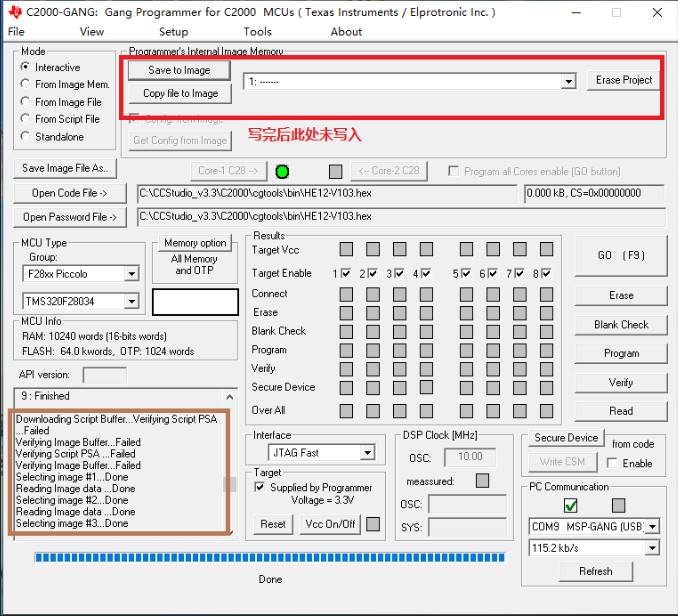

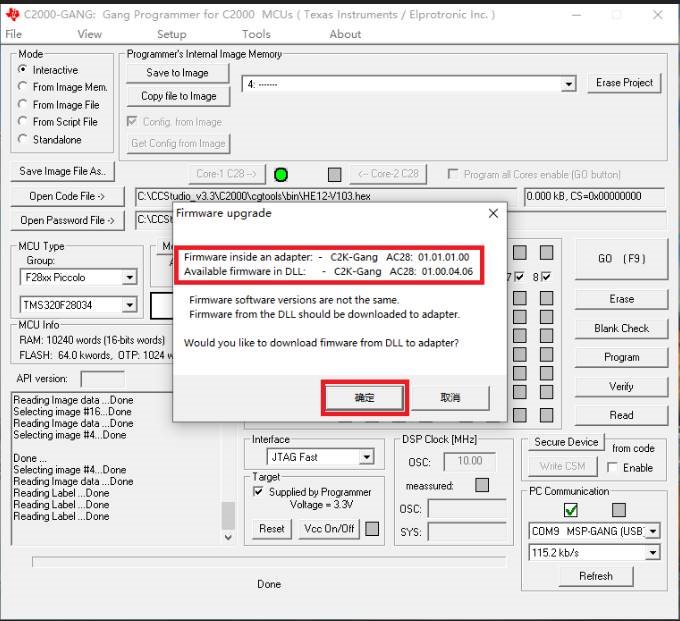

新买的C2000-GANG,安装从TI官网下载C2000-GANG-1V046-Setup.zip后,打开C2000-GANG软件,并将设备通过USB连接到笔记本电脑。弹出如下对话框:
显示离线烧录器内的固件版本为01.01.01.00,而官网下载的C2000-GANG软件版本为:01.00.04.06,点击“确定”后,离线烧录器内固件被刷为01.00.04.06。

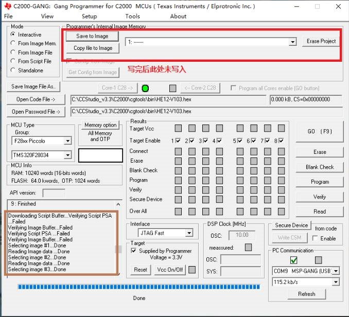

执行Copy file to Image后,无法存储程序,显示如下第2图:
Selftest报告

109: Vcc Target-4 ( #8 ON )         0.00 V  (  0.00 to   0.50)  Result:  0.17 V   ... >>  OK   <<
110: Vcc Target-5 ( #8 ON )         0.00 V  (  0.00 to   0.50)  Result:  0.17 V   ... >>  OK   <<
111: Vcc Target-6 ( #8 ON )         0.00 V  (  0.00 to   0.50)  Result:  0.17 V   ... >>  OK   <<
112: Vcc Target-7 ( #8 ON )         0.00 V  (  0.00 to   0.50)  Result:  0.17 V   ... >>  OK   <<
113: Vcc Target-8 ( #8 ON )         3.30 V  (  3.10 to   3.50)  Result:  0.17 V   ... >> ERROR <<
114: SD Power OFF                  0x0000   (0x0000  - 0x0000)  Result:  0x00     ... >>  OK   <<
115: SD Power ON                   0x0001   (0x0001  - 0x0001)  Result:  0x01     ... >>  OK   <<
116: SD Discharge -  delay 2ms     0x0010   (0x0001  - 0x0001)  Result:  0x01     ... >>  OK   <<
117: SD Discharge -  delay 50ms    0x0010   (0x0000  - 0x0000)  Result:  0x00     ... >>  OK   <<
118: BSL RX bus (#1 HIGH)          0x0001   (0x0001  - 0x0001)  Result:  0x01     ... >>  OK   <<
119: BSL RX bus (#2 HIGH)          0x0002   (0x0002  - 0x0002)  Result:  0x02     ... >>  OK   <<
120: BSL RX bus (#3 HIGH)          0x0004   (0x0004  - 0x0004)  Result:  0x04     ... >>  OK   <<
121: BSL RX bus (#4 HIGH)          0x0008   (0x0008  - 0x0008)  Result:  0x08     ... >>  OK   <<
122: BSL RX bus (#5 HIGH)          0x0010   (0x0010  - 0x0010)  Result:  0x10     ... >>  OK   <<
123: BSL RX bus (#6 HIGH)          0x0020   (0x0020  - 0x0020)  Result:  0x20     ... >>  OK   <<
124: BSL RX bus (#7 HIGH)          0x0040   (0x0040  - 0x0040)  Result:  0x40     ... >>  OK   <<
125: BSL RX bus (#8 HIGH)          0x0080   (0x0080  - 0x0080)  Result:  0x80     ... >>  OK   <<
126: BSL TX bus (#1 HIGH)          0x0001   (0x0001  - 0x0001)  Result:  0x01     ... >>  OK   <<
127: BSL TX bus (#2 HIGH)          0x0002   (0x0002  - 0x0002)  Result:  0x02     ... >>  OK   <<
128: BSL TX bus (#3 HIGH)          0x0004   (0x0004  - 0x0004)  Result:  0x04     ... >>  OK   <<
129: BSL TX bus (#4 HIGH)          0x0008   (0x0008  - 0x0008)  Result:  0x08     ... >>  OK   <<
130: BSL TX bus (#5 HIGH)          0x0010   (0x0010  - 0x0010)  Result:  0x10     ... >>  OK   <<
131: BSL TX bus (#6 HIGH)          0x0020   (0x0020  - 0x0020)  Result:  0x20     ... >>  OK   <<
132: BSL TX bus (#7 HIGH)          0x0040   (0x0040  - 0x0040)  Result:  0x40     ... >>  OK   <<
133: BSL TX bus (#8 HIGH)          0x0080   (0x0080  - 0x0080)  Result:  0x80     ... >>  OK   <<
134: TDI bus  (#8 HIGH)            0x0080   (0x0080  - 0x0080)  Result:  0x80     ... >>  OK   <<
135: TDI bus  (#1 HIGH)            0x0001   (0x0001  - 0x0001)  Result:  0x01     ... >>  OK   <<
136: TDI bus  (#2 HIGH)            0x0002   (0x0002  - 0x0002)  Result:  0x02     ... >>  OK   <<
137: TDI bus  (#3 HIGH)            0x0004   (0x0004  - 0x0004)  Result:  0x04     ... >>  OK   <<
138: TDI bus  (#4 HIGH)            0x0008   (0x0008  - 0x0008)  Result:  0x08     ... >>  OK   <<
139: TDI bus  (#5 HIGH)            0x0010   (0x0010  - 0x0010)  Result:  0x10     ... >>  OK   <<
140: TDI bus  (#6 HIGH)            0x0020   (0x0020  - 0x0020)  Result:  0x20     ... >>  OK   <<
141: TDI bus  (#7 HIGH)            0x0040   (0x0040  - 0x0040)  Result:  0x40     ... >>  OK   <<
142: TDIO Tx-bus (#1 HIGH)         0x0001   (0x0001  - 0x0001)  Result:  0x01     ... >>  OK   <<
143: TDIO Tx-bus (#2 HIGH)         0x0002   (0x0002  - 0x0002)  Result:  0x02     ... >>  OK   <<
144: TDIO Tx-bus (#3 HIGH)         0x0004   (0x0004  - 0x0004)  Result:  0x04     ... >>  OK   <<
145: TDIO Tx-bus (#4 HIGH)         0x0008   (0x0008  - 0x0008)  Result:  0x08     ... >>  OK   <<
146: TDIO Tx-bus (#5 HIGH)         0x0010   (0x0010  - 0x0010)  Result:  0x10     ... >>  OK   <<
147: TDIO Tx-bus (#6 HIGH)         0x0020   (0x0020  - 0x0020)  Result:  0x20     ... >>  OK   <<
148: TDIO Tx-bus (#7 HIGH)         0x0040   (0x0040  - 0x0040)  Result:  0x40     ... >>  OK   <<
149: TDIO Tx-bus (#8 HIGH)         0x0080   (0x0080  - 0x0080)  Result:  0x80     ... >>  OK   <<
150: TDIO Tx-Rx (#1 HIGH)          0x0001   (0x0001  - 0x0001)  Result:  0x01     ... >>  OK   <<
151: TDIO Tx-Rx (#2 HIGH)          0x0002   (0x0002  - 0x0002)  Result:  0x02     ... >>  OK   <<
152: TDIO Tx-Rx (#3 HIGH)          0x0004   (0x0004  - 0x0004)  Result:  0x04     ... >>  OK   <<
153: TDIO Tx-Rx (#4 HIGH)          0x0008   (0x0008  - 0x0008)  Result:  0x08     ... >>  OK   <<
154: TDIO Tx-Rx (#5 HIGH)          0x0010   (0x0010  - 0x0010)  Result:  0x10     ... >>  OK   <<
155: TDIO Tx-Rx (#6 HIGH)          0x0020   (0x0020  - 0x0020)  Result:  0x20     ... >>  OK   <<
156: TDIO Tx-Rx (#7 HIGH)          0x0040   (0x0040  - 0x0040)  Result:  0x40     ... >>  OK   <<
157: TDIO Tx-Rx (#8 HIGH)          0x0080   (0x0080  - 0x0080)  Result:  0x80     ... >>  OK   <<
158: TDIO Rx-bus (#1 HIGH)         0x0001   (0x0001  - 0x0001)  Result:  0x01     ... >>  OK   <<
159: TDIO Rx-bus (#2 HIGH)         0x0002   (0x0002  - 0x0002)  Result:  0x02     ... >>  OK   <<
160: TDIO Rx-bus (#3 HIGH)         0x0004   (0x0004  - 0x0004)  Result:  0x04     ... >>  OK   <<
161: TDIO Rx-bus (#4 HIGH)         0x0008   (0x0008  - 0x0008)  Result:  0x08     ... >>  OK   <<
162: TDIO Rx-bus (#5 HIGH)         0x0010   (0x0010  - 0x0010)  Result:  0x10     ... >>  OK   <<
163: TDIO Rx-bus (#6 HIGH)         0x0020   (0x0020  - 0x0020)  Result:  0x20     ... >>  OK   <<
164: TDIO Rx-bus (#7 HIGH)         0x0040   (0x0040  - 0x0040)  Result:  0x40     ... >>  OK   <<
165: TDIO Rx-bus (#84 HIGH)        0x0080   (0x0080  - 0x0080)  Result:  0x80     ... >>  OK   <<
166: TMS bus (All HIGH)            0x00FF   (0x00FF  - 0x00FF)  Result:  0xFF     ... >>  OK   <<
167: TMS bus (All LOW)             0x0000   (0x0000  - 0x0000)  Result:  0x00     ... >>  OK   <<
168: TMS bus (#1 HIGH)             0x0001   (0x0001  - 0x0001)  Result:  0x01     ... >>  OK   <<
169: TMS bus (#2 HIGH)             0x0002   (0x0002  - 0x0002)  Result:  0x02     ... >>  OK   <<
170: TMS bus (#3 HIGH)             0x0004   (0x0004  - 0x0004)  Result:  0x04     ... >>  OK   <<
171: TMS bus (#4 HIGH)             0x0008   (0x0008  - 0x0008)  Result:  0x08     ... >>  OK   <<
172: TMS bus (#5 HIGH)             0x0010   (0x0010  - 0x0010)  Result:  0x10     ... >>  OK   <<
173: TMS bus (#6 HIGH)             0x0020   (0x0020  - 0x0020)  Result:  0x20     ... >>  OK   <<
174: TMS bus (#7 HIGH)             0x0040   (0x0040  - 0x0040)  Result:  0x40     ... >>  OK   <<
175: TMS bus (#8 HIGH)             0x0080   (0x0080  - 0x0080)  Result:  0x80     ... >>  OK   <<
176: RST bus (All HIGH)            0x00FF   (0x00FF  - 0x00FF)  Result:  0xFF     ... >>  OK   <<
177: RST bus (All LOW)             0x0000   (0x0000  - 0x0000)  Result:  0x00     ... >>  OK   <<
178: RST bus (#1 HIGH)             0x0001   (0x0001  - 0x0001)  Result:  0x01     ... >>  OK   <<
179: RST bus (#2 HIGH)             0x0002   (0x0002  - 0x0002)  Result:  0x02     ... >>  OK   <<
180: RST bus (#3 HIGH)             0x0004   (0x0004  - 0x0004)  Result:  0x04     ... >>  OK   <<
181: RST bus (#4 HIGH)             0x0008   (0x0008  - 0x0008)  Result:  0x08     ... >>  OK   <<
182: RST bus (#5 HIGH)             0x0010   (0x0010  - 0x0010)  Result:  0x10     ... >>  OK   <<
183: RST bus (#6 HIGH)             0x0020   (0x0020  - 0x0020)  Result:  0x20     ... >>  OK   <<
184: RST bus (#7 HIGH)             0x0040   (0x0040  - 0x0040)  Result:  0x40     ... >>  OK   <<
185: RST bus (#8 HIGH)             0x0080   (0x0080  - 0x0080)  Result:  0x80     ... >>  OK   <<
186: Keys buffer (All pull-up)     0x001F   (0x001F  - 0x001F)  Result:  0x1F     ... >>  OK   <<
187: Access to LCD RAM (0xAA)      0x00AA   (0x00AA  - 0x00AA)  Result:  0xAA     ... >>  OK   <<
188: Access to LCD RAM (0x99)      0x0099   (0x0099  - 0x0099)  Result:  0x99     ... >>  OK   <<
189: Image Flash Access (get ID)   0x0002   (0x0001  - 0x0002)  Result:  0x00     ... >> ERROR <<
190: TDI Fuse keys (#1 ON)         0x0001   (0x0001  - 0x0001)  Result:  0x01     ... >>  OK   <<
191: TDI Fuse keys (#2 ON)         0x0002   (0x0002  - 0x0002)  Result:  0x02     ... >>  OK   <<
192: TDI Fuse keys (#3 ON)         0x0004   (0x0004  - 0x0004)  Result:  0x04     ... >>  OK   <<
193: TDI Fuse keys (#4 ON)         0x0008   (0x0008  - 0x0008)  Result:  0x08     ... >>  OK   <<
194: TDI Fuse keys (#5 ON)         0x0010   (0x0010  - 0x0010)  Result:  0x10     ... >>  OK   <<
195: TDI Fuse keys (#6 ON)         0x0020   (0x0020  - 0x0020)  Result:  0x20     ... >>  OK   <<
196: TDI Fuse keys (#7 ON)         0x0040   (0x0040  - 0x0040)  Result:  0x40     ... >>  OK   <<
197: TDI Fuse keys (#8 ON)         0x0080   (0x0080  - 0x0080)  Result:  0x80     ... >>  OK   <<
198: TEST Fuse keys (#1 ON)         1.00    (  2.80 to   3.50)  Result:  0.00     ... >> ERROR <<
199: TEST Fuse keys (#2 ON)         2.00    (  2.80 to   3.50)  Result:  0.00     ... >> ERROR <<
200: TEST Fuse keys (#3 ON)         3.00    (  2.80 to   3.50)  Result:  0.00     ... >> ERROR <<
201: TEST Fuse keys (#4 ON)         4.00    (  2.80 to   3.50)  Result:  0.00     ... >> ERROR <<
202: TEST Fuse keys (#5 ON)         5.00    (  2.80 to   3.50)  Result:  0.00     ... >> ERROR <<
203: TEST Fuse keys (#6 ON)         6.00    (  2.80 to   3.50)  Result:  0.00     ... >> ERROR <<
204: TEST Fuse keys (#7 ON)         7.00    (  2.80 to   3.50)  Result:  0.00     ... >> ERROR <<
205: TEST Fuse keys (#8 ON)         8.00    (  2.80 to   3.50)  Result:  0.00     ... >> ERROR <<
============== Finished =================================
*  Test failed!!  33 error(s).
