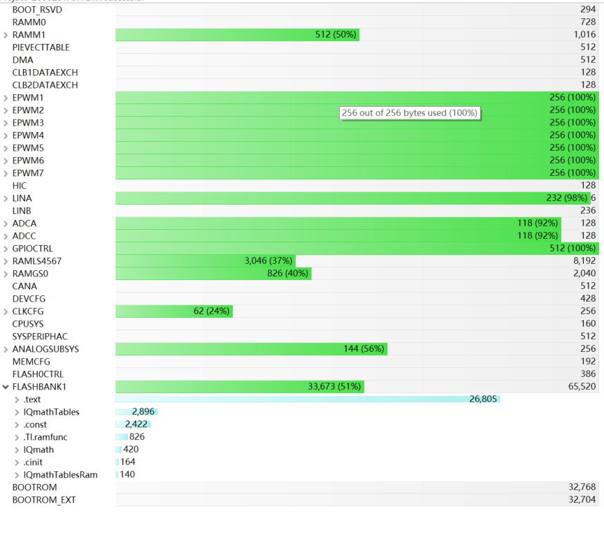

  • 还有个问题,程序 我是从28034上移植到280023上,现在但FLASHBANK1超过50%时程序编译通过,烧写程序时擦除FLASH后,烧写进度走了一段后就报错 Load program Error。只要将代码减少到FLASHBANK1小于50%时,烧写都正常,程序也能跑。

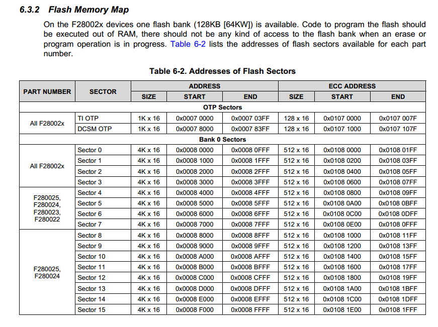

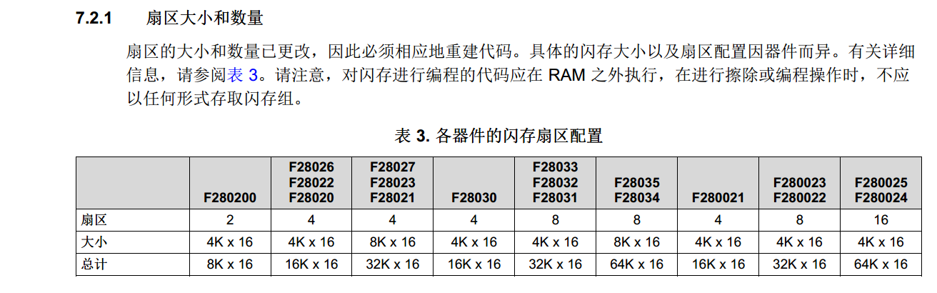

  • 当FLASH空间超过50%时烧写出错是不是280023的FLASH空间只有32K,28034的FLASH空间有64K,我用的CMD文件是C2000 WARE SDK 中的28002x_generic_flash_lnk.cmd。
    28002x_generic_flash_lnk.cmd 中FLASH空间如下
    /* Flash sectors */
    /* BANK 0 */
    FLASH_BANK0_SEC0 : origin = 0x080002, length = 0x000FFE /* on-chip Flash */
    FLASH_BANK0_SEC1 : origin = 0x081000, length = 0x001000 /* on-chip Flash */
    FLASH_BANK0_SEC2 : origin = 0x082000, length = 0x001000 /* on-chip Flash */
    FLASH_BANK0_SEC3 : origin = 0x083000, length = 0x001000 /* on-chip Flash */
    FLASH_BANK0_SEC4 : origin = 0x084000, length = 0x001000 /* on-chip Flash */
    FLASH_BANK0_SEC5 : origin = 0x085000, length = 0x001000 /* on-chip Flash */
    FLASH_BANK0_SEC6 : origin = 0x086000, length = 0x001000 /* on-chip Flash */
    FLASH_BANK0_SEC7 : origin = 0x087000, length = 0x001000 /* on-chip Flash */
    FLASH_BANK0_SEC8 : origin = 0x088000, length = 0x001000 /* on-chip Flash */
    FLASH_BANK0_SEC9 : origin = 0x089000, length = 0x001000 /* on-chip Flash */
    FLASH_BANK0_SEC10 : origin = 0x08A000, length = 0x001000 /* on-chip Flash */
    FLASH_BANK0_SEC11 : origin = 0x08B000, length = 0x001000 /* on-chip Flash */
    FLASH_BANK0_SEC12 : origin = 0x08C000, length = 0x001000 /* on-chip Flash */
    FLASH_BANK0_SEC13 : origin = 0x08D000, length = 0x001000 /* on-chip Flash */
    FLASH_BANK0_SEC14 : origin = 0x08E000, length = 0x001000 /* on-chip Flash */
    FLASH_BANK0_SEC15 : origin = 0x08F000, length = 0x000FF0 /* on-chip Flash */
  • 谢谢您的详细信息。看起来是flash大小差异引起的这样的问题。目前您map文件中显示flash使用量是多少?

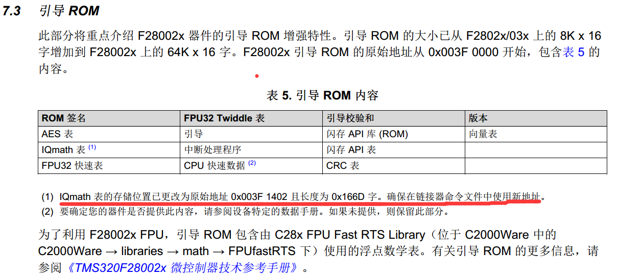

  • 对比280023 与 28034 IQmath有区别
    在280023 CMD 文件中是否要添加以下代码(/* 此处IQmath */) ,
    FLASHBANK1 : origin = 0x00080002, length = 0x00007FF0
    FLASH_BANK1_RSVD : origin = 0x0008FFF2, length = 0x0000000D /* Reserve and do not use for code as per the errata advisory "Memory: Prefetching Beyond Valid Memory" */
    IQTABLES : origin = 0x3F1402, length = 0x00166D    /* 此处IQmath */
    BOOTROM : origin = 0x003F0000, length = 0x00001400
    BOOTROM1 : origin = 0x003F2A6F, length = 0x00005000
    BOOTROM_EXT : origin = 0x003F8000, length = 0x00007FC0
    RESET : origin = 0x003FFFC0, length = 0x00000002
    IQmath : > FLASHBANK1    /* 此处IQmath */
    IQmathTables : > IQTABLES , TYPE = NOLOAD   /* 此处IQmath */
    IQmathTablesRam : > RAMLS4567   /* 此处IQmath */
    不知是否正确?请指教!

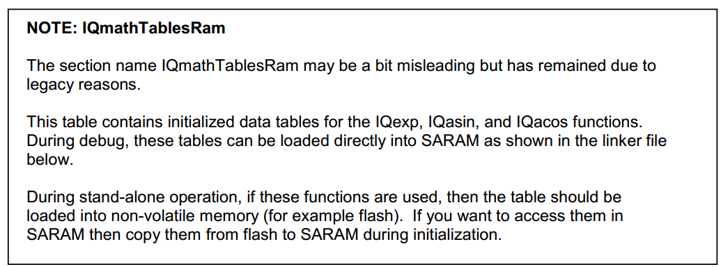

  • 解决了,IQmath的设置问题,IQmathTablesRam 这个段要用在FlASH中,IQmath手册上有说。感谢支持!!!
