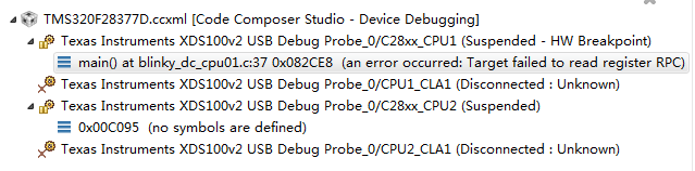

本人最近在尝试使用28377D的双核功能时,具体操作如下:
1.先适当修改了 ......\ti\controlSUITE\device_support\F2837xD\v210\F2837xD_examples_Dual\blinky_dc 的程序,让CPU1不停翻转GPIO78,CPU2不停翻转GPIO79;
2.烧录时如果烧录的是在线运行的程序时,是可以正常烧录的,而且程序也可以正常运行,可以看到2个IO口的LED交替闪烁;
3.再次尝试把程序烧录到flash中;
3.1 首先分别设定cpu1和cpu2为CPU1_FLASH_STANDALONE和CPU2_FLASH模式并分别编译;
3.2 在DEBUG中分别connect target CPU1和CPU2;
3.3 选中cpu1,点击RUN->LOAD->LOAD PROGRAM,选择3.1编译生成后的CPU1对应的.out文件,可以正常烧录但是程序且停在相应的main函数中,如下图所示:
3.4 但是当我尝试烧录cpu2时,发现烧录不进去,DEBUG提示如下:
且CONSOLE反复输出如下信息:
C28xx_CPU1: Trouble Reading Register PC: (Error -1137 @ 0x0) Device is held in reset. Take the device out of reset, and retry the operation. (Emulation package 8.4.0.00006)

C28xx_CPU2: Error occurred during flash operation: Timed out waiting for target to halt while executing wr_pll.alg
C28xx_CPU2: Error writing the PLL values (Flash algorithm timed out). Operation cancelled.
C28xx_CPU2: Perform a debugger reset and execute the Boot-ROM code (click on the RESUME button in CCS debug window) before erasing/loading the Flash. If that does not help to perform a successful Flash erase/load, check the Reset cause (RESC) register, NMI shadow flag (NMISHDFLG) register and the Boot-ROM status register for further debug.
C28xx_CPU2: Trouble Reading Register PC: (Error -1137 @ 0x0) Device is held in reset. Take the device out of reset, and retry the operation. (Emulation package 8.4.0.00006)
C28xx_CPU2: Trouble Removing Breakpoint with the Action "Remain Halted" at 0xc0eb: (Error -1137 @ 0x6) Device is held in reset. Take the device out of reset, and retry the operation. (Emulation package 8.4.0.00006)
C28xx_CPU2: Trouble Reading Register ST1: (Error -1137 @ 0x6) Device is held in reset. Take the device out of reset, and retry the operation. (Emulation package 8.4.0.00006)
C28xx_CPU2: Error occurred during flash operation: Internal error while writing 0x0005F444@Data

我除了将程序稍作改动外,其他的配置一概没动,不清楚问题的原因,请及时回复,谢谢
