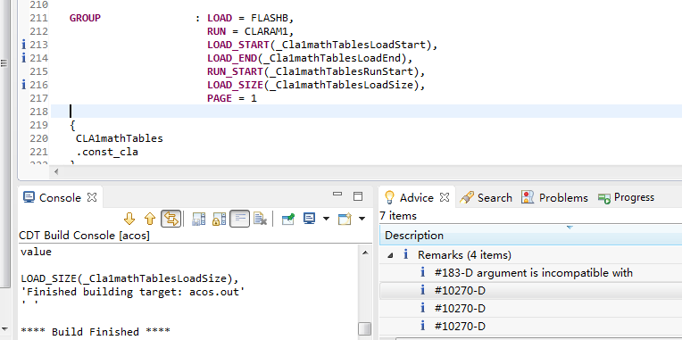

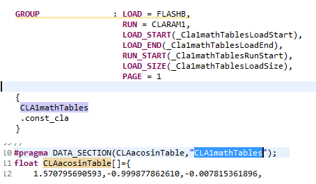

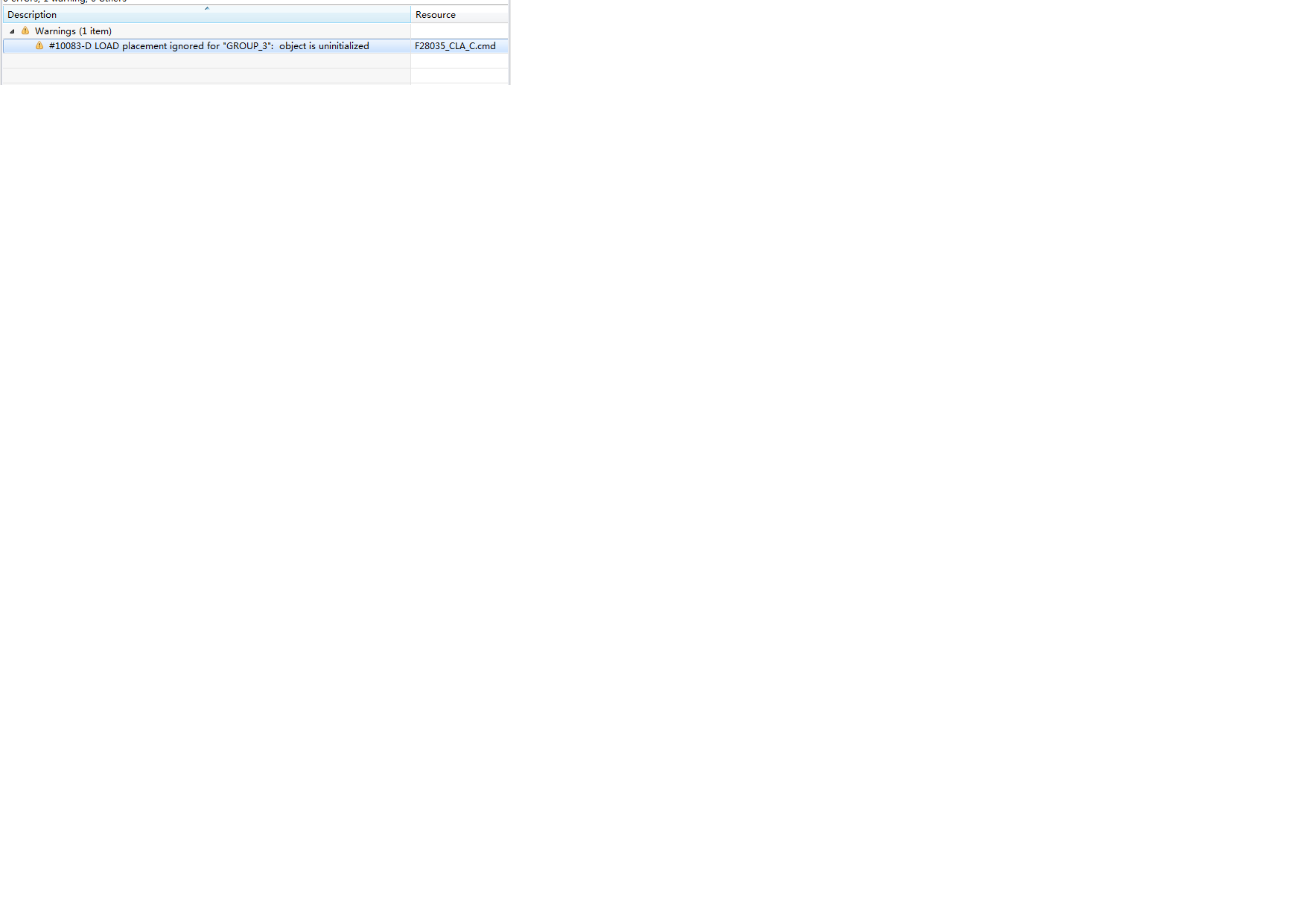

Description Resource Path Location Type
#10083-D LOAD placement ignored for "GROUP_3": object is uninitialized F28035_CLA_C.cmd /CLA_TEST/DSP2803x_common/cmd line 181 C/C++ Problem
建议您使用C2000ware内的例程及文件,我用controlSUITE编译例程也是会有警告,而使用新版的C2000ware则没有问题
