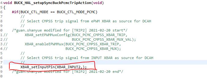

我现在正在配置TMS320F28379D的INPUT-XBAR。当我使用函数XBAR_setInputPin()函数的时候,函数有一个参数是需要GPIO管脚号,但是我发现我找不到CMPSSIN2P对应的管脚号,请问CMPSSIN2P对应管脚号是多少?

请问能否给出您程序的出处?我们具体看一下。另外
typedef enum
XBAR_INPUT1, //!< ePWM[TZ1], ePWM[TRIP1], X-BARs, eCAPs
XBAR_INPUT2, //!< ePWM[TZ2], ePWM[TRIP2], X-BARs, eCAPs
XBAR_INPUT3, //!< ePWM[TZ3], ePWM[TRIP3], X-BARs, eCAPs
XBAR_INPUT4, //!< ADC wrappers, X-BARs, XINT1, eCAPs
XBAR_INPUT5, //!< EXTSYNCIN1, X-BARs, XINT2, eCAPs
XBAR_INPUT6, //!< EXTSYNCIN2, ePWM[TRIP6], X-BARs, XINT3, eCAPs
XBAR_INPUT7, //!< X-BARs, eCAPs
XBAR_INPUT8, //!< X-BARs, eCAPs
XBAR_INPUT9, //!< X-BARs, eCAPs
XBAR_INPUT10, //!< X-BARs, eCAPs
XBAR_INPUT11, //!< X-BARs, eCAPs
XBAR_INPUT12, //!< X-BARs, eCAPs
XBAR_INPUT13, //!< XINT4, X-BARs, eCAPs
XBAR_INPUT14, //!< XINT5, X-BARs, eCAPs
XBAR_INPUT15, //!< eCAPs
XBAR_INPUT16 //!< eCAPs
} XBAR_InputNum;
