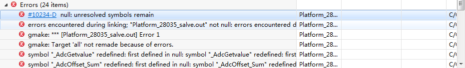

类似下面这种错误?
error #10056: symbol "_AdcGetvalue" redefined: first defined in
"./DSP2803x_common/source/DSP2803x_DefaultIsr.obj"; redefined in
"./DSP2803x_common/source/DSP2803x_user.obj"
根据提示是您在DSP2803x_DefaultIsr和DSP2803x_user中重复定义了
