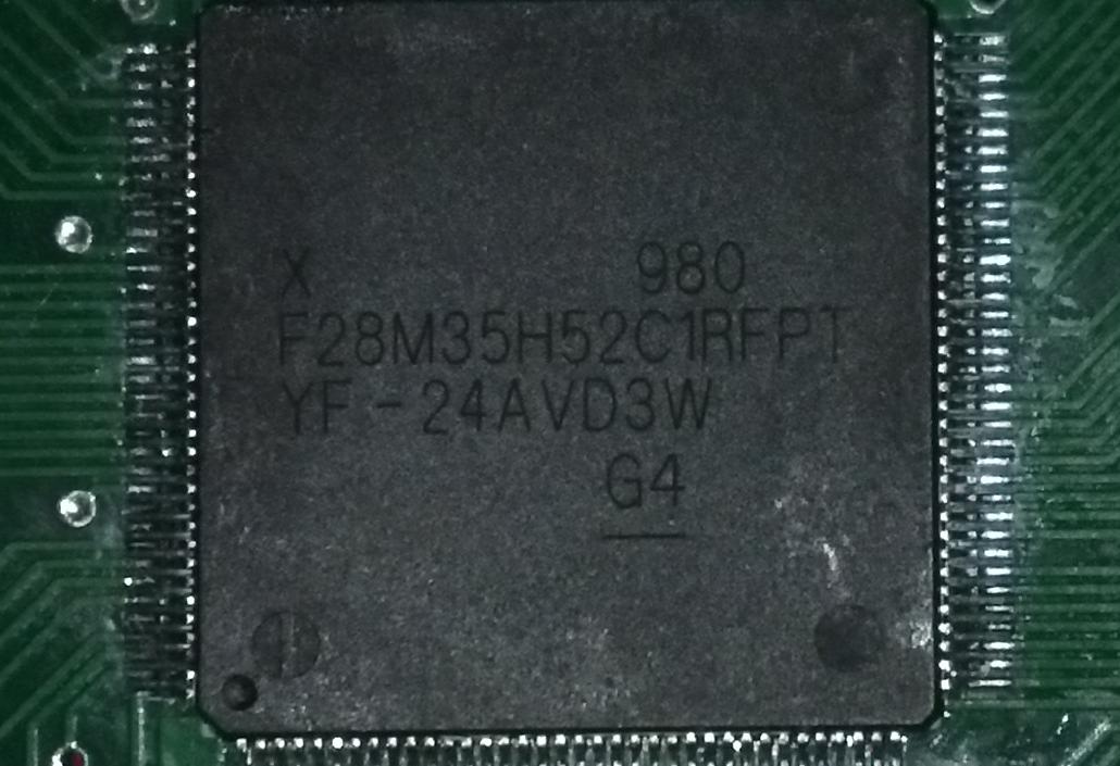

我读MEMORY中0x400f e000的内容是0x2040 0000,是不是版本还是0啊?年份代码2012年4月份流片的,我2013年一月份购买的,不应该是Version 0 吧!
wang,
你这个芯片的版本是实验版本芯片,并不是最终发布量产的芯片。所以不属于0或A版本。
xF28M35... Experimental device that is not necessarily representative of the final device's electrical specifications
pF28M35... Final silicon die that conforms to the device's electrical specifications but has not completed quality and reliability verification
F28M35... Fully qualified production device
