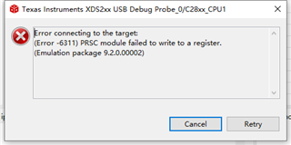

您好。我使用的芯片是TMS320F28388DZWTS,设计了电路板,第一块板子可以正常运行,程序可以正常下载,数据可以正常出现。
(不过,存在一个问题:给电路板供电的电源是4.9V,但是连接到我设计的电路板上,测量电路板的电压是4.3v)
除此之外,同样的设计,同样的厂家制作。另一块电路板,在下载程序的时候,就出现了上面图片中的问题。一般来说,这种错误代码:表示什么含义呢?

Execute the command:
%ccs_base%/common/uscif/dbgjtag -f %boarddatafile% -rv -o -S integrity
[Result]
-----[Print the board config pathname(s)]------------------------------------
C:\Users\DELL\AppData\Local\TEXASI~1\CCS\
CCS10I~1\0\0\BrdDat\testBoard.dat
-----[Print the reset-command software log-file]-----------------------------
This utility has selected a 560/2xx-class product.
This utility will load the program 'xds2xxu.out'.
The library build date was 'May 7 2020'.
The library build time was '20:23:44'.
The library package version is '9.2.0.00002'.
The library component version is '35.35.0.0'.
The controller does not use a programmable FPGA.
The controller has a version number of '13' (0x0000000d).
The controller has an insertion length of '0' (0x00000000).
This utility will attempt to reset the controller.
This utility has successfully reset the controller.
-----[Print the reset-command hardware log-file]-----------------------------
This emulator does not create a reset log-file.
-----[Perform the Integrity scan-test on the JTAG IR]------------------------
This test will use blocks of 64 32-bit words.
This test will be applied just once.
Do a test using 0xFFFFFFFF.
Scan tests: 1, skipped: 0, failed: 0
Do a test using 0x00000000.
Scan tests: 2, skipped: 0, failed: 0
Do a test using 0xFE03E0E2.
Scan tests: 3, skipped: 0, failed: 0
Do a test using 0x01FC1F1D.
Scan tests: 4, skipped: 0, failed: 0
Do a test using 0x5533CCAA.
Scan tests: 5, skipped: 0, failed: 0
Do a test using 0xAACC3355.
Scan tests: 6, skipped: 0, failed: 0
All of the values were scanned correctly.
The JTAG IR Integrity scan-test has succeeded.

这是YXDSP-XD200仿真器连接电路板后的状态
这是正常运行的板子还是报错的板子的连接状态?
这个报错我没有遇到过,查了一下论坛,也没有在C2000的论坛中出现过这个报错。查了一下百度,但结果都是基于C6000系列芯片的,你可以参考一下:https://blog.csdn.net/liuning1898/article/details/89299632
最接近的是英文E2E上的帖子,似乎跟你的情况有可能对得上号:https://e2e.ti.com/support/microcontrollers/c2000-microcontrollers-group/c2000/f/c2000-microcontrollers-forum/917546/ccs-tms320f280049-tms320f280049-random-jtag-issue/3391063?tisearch=e2e-sitesearch&keymatch="error%20-6311"#3391063
另外,你的4.9V电源应该是给降压芯片供电的?实际供电到芯片的电压是多少?
第一块板子可以正常运行
应该说明供电到芯片的电压还是3.3V?
