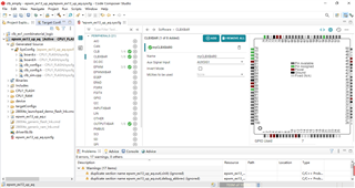

如何将CLB与输出的GPIO对应配置,软件中配置的怎么都是仿真的

软件中配置的怎么都是仿真的
没太理解您的意思,能否详细说一下?
例如如何将PWM从CLB的一个GPIO输出配置没用成功
请您看一下

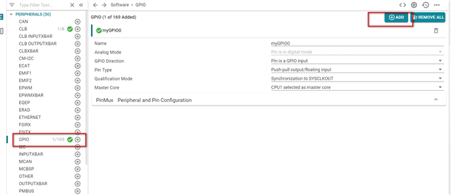

该例程内下面的代码用于实现pwm的输出。
// Configure OUTPUT-XBAR OUTPUT1 as CLB1_OUT4
XBAR_setOutputMuxConfig(XBAR_OUTPUT1, XBAR_OUT_MUX01_CLB1_OUT4);
XBAR_enableOutputMux(XBAR_OUTPUT1, XBAR_MUX01);
而不能通过.syscfg配置?
目前没有直接的操作syscfg的说明(应该是clb的syscfg功能还没有完善)
On F28004x family you have limited options. On F28002x and F2838x you can send all of the outputs of a given tile to a GPIO.
On F28004x,
For example for CLB1 ,you can:
OUT4/5 to OUTPUTXBAR to GPIO.
OUT0 to EPWM1A to GPIO
OUT2 to EPWM1B to GPIO
Then you can use OUT1 (which is copied to OUT17), OUT3 (which is copied to OUT19), OUT6 (which is copied to OUT22) and OUT7(which is copied to OUT23) to another CLB through the GLOBAL MUX OF CLB, and try exporting them out through the OTHER CLB TILEs (CLB2, 3, 4).
