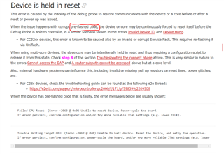

TMS320F28377D: 28377想要结束调试时,点击CCS 的CPU RESET报错
Part Number: TMS320F28377D
C28xx_CPU1: Failed CPU Reset: (Error -1138 @ 0x0) Device refused to allow debug mode. Power-cycle the board. If error persists, confirm configuration and/or try more reliable JTAG settings (e.g. lower TCLK). (Emulation package 9.3.0.00058)
在 http://software-dl.ti.com/ccs/esd/documents/ccsv7_debugging_jtag_connectivity_issues.html#the-emulator-reported-an-error 里找不到1138错误
另外,请问什么是pre-flashed code?
