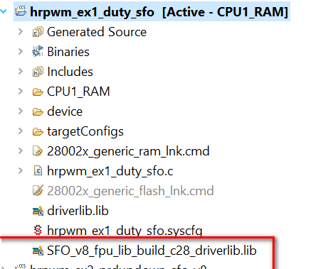

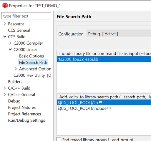

fatal error #16000: object files have incompatible formats ("D:/soft/CCS/ccsv8/tools/compiler/ti-cgt-c2000_21.6.0.LTS/lib/rts2800_ml.lib<boot28.asm.obj>" = TI-COFF, "./USER/main.obj" = ELF)
编译报这个错是什么问题呢,求大神解答
