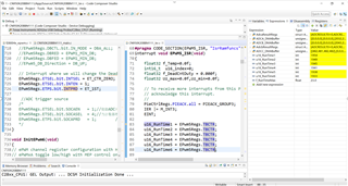

Part Number: TMS320F280049
你好:
在程序中,通过EPWM5,在ET_CTR_ZERO时刻使能中断,配置如下:
// Interrupt where we will change the Deadband
EPwm5Regs.ETSEL.bit.INTSEL = ET_CTR_ZERO; // Select INT on Prd event
EPwm5Regs.ETSEL.bit.INTEN = 1; // Enable INT
EPwm5Regs.ETPS.bit.INTPRD = ET_1ST; // Generate INT on 1st event
但是在程序中,通过读取初始段TBCRT数值,发现始终是从TBPRD开始的下降过程,感觉这个与配置不符
尝试将触发时刻更改为PRD时刻,读取的数值还是从从TBPRD开始的下降过程,
感觉始终是从PRD进入,这个配置对中断进入时刻没有影响,与配置文件不符,反复核查配置文件,没有发现为什么一直是PRD时刻进入中断,能不能帮忙看一下什么原因,多谢。
附件为PWM配置文件。

void InitEPwm5(void)
// ePWM channel register configuration with HRPWM
// ePWMxA toggle low/high with MEP control on Rising edge
EALLOW;
CpuSysRegs.PCLKCR0.bit.TBCLKSYNC = 0; // Disable TBCLK within the EPWM
EDIS;
///EPWM5 config config for PWM2A/2B
EPwm5Regs.TBCTL.bit.PRDLD = TB_SHADOW; // set Shadow load
EPwm5Regs.TBPRD = EPWM1_TIMER_TBPRD; // (60M/250k-1)=239 Set timer period-120kHz,PWM frequency = 1/(2*TBPRD)
EPwm5Regs.CMPA.bit.CMPA = EPWM1_MIN_CMPA;
EPwm5Regs.CMPA.bit.CMPAHR = 0; // initialize HRPWM extension
EPwm5Regs.CMPB.bit.CMPB = EPWM1_TIMER_TBPRD - EPWM1_MIN_CMPA;
EPwm5Regs.CMPB.bit.CMPBHR = 0;
EPwm5Regs.TBPHS.all = 0;
EPwm5Regs.TBCTR = 0;
// Setup TBCLK
EPwm5Regs.TBCTL.bit.CTRMODE = TB_COUNT_UPDOWN; // Count up
EPwm5Regs.TBCTL.bit.PHSEN = TB_ENABLE; // Disable phase loading
EPwm5Regs.TBCTL.bit.HSPCLKDIV = TB_DIV1; // Clock ratio to SYSCLKOUT
EPwm5Regs.TBCTL.bit.CLKDIV = TB_DIV1; // TBCLK = SYSCLKOUT / (HSPCLKDIV �� CLKDIV)
EPwm5Regs.TBCTL.bit.SYNCOSEL = TB_SYNC_IN; // PWM5ͬ��
EPwm5Regs.TBCTL.bit.PHSDIR = TB_UP;
EPwm5Regs.CMPCTL.bit.SHDWAMODE = CC_SHADOW; // Load registers every ZERO
EPwm5Regs.CMPCTL.bit.SHDWBMODE = CC_SHADOW;
EPwm5Regs.CMPCTL.bit.LOADAMODE = CC_CTR_ZERO_PRD;
EPwm5Regs.CMPCTL.bit.LOADBMODE = CC_CTR_ZERO_PRD;
// Setup compare
// Set actions
EPwm5Regs.AQCTLA.bit.CAD = AQ_SET; // Set PWM5A on Zero
EPwm5Regs.AQCTLA.bit.CAU = AQ_CLEAR;
EPwm5Regs.AQCTLB.bit.CBD = AQ_CLEAR; // Set PWM5A on Zero
EPwm5Regs.AQCTLB.bit.CBU = AQ_SET;
// Active Low PWMs - Setup Deadband
EPwm5Regs.DBCTL.bit.OUT_MODE = DB_DISABLE; //����������
//EPwm5Regs.DBCTL.bit.POLSEL = DB_ACTV_LO;
//EPwm5Regs.DBCTL.bit.IN_MODE = DBA_ALL;
//EPwm5Regs.DBRED = EPWM1_MIN_DB;
// EPwm5Regs.DBFED = EPWM1_MIN_DB;
//EPwm5_DB_Direction = DB_UP;
