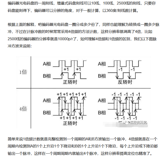

  •  位置分辨率是这样的概念? 想问一下QEP里具体是怎么实现的?
  • 似乎instaSPIN里面没有涉及到位置分辨率的部分。看到lab手册上有这样一段描述:
    It is important for the setup and configuration of the ENC module that the number of lines on the encoder be provided. This allows the ENC module to correctly convert encoder counts into an angle. This value is represented by USER_MOTOR_ENCODER_LINES. This value needs to be defined in user.h as part of the user motor definitions. This value must be updated to the correct value for your encoder. If this value is not correct the motor will spin faster or slower depending on if the value you set. It is important to note that this value should be set to the number of lines on the encoder, not the resultant number of counts after figuring the quadrature accuracy.
    C:\ti\motorware\motorware_1_01_00_18\docs\labs
  • 手册中即是说填的是编码器线数,不是脉冲沿计数值.
    那么我具体想知道QEP模块的计数模式,应该是
    这里图中的哪一种呢? 是否是4倍频的计数方式?
  • 图中其实就2种计数方式,1倍和4倍频。按照文档种说的
    我认为就是1倍频的计数方式。
    至于正转反转应该是根据AB相的相位差来判定的,跟计数方式没关系。
