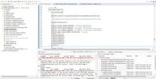

用RAM build后 会出现以下问题
细部error如下:
"../F28035_RAM_HVACI_Sensorless.CMD", line 82: error: program will not fit into
available memory, or the section contains a call site that requires a
trampoline that can't be generated for this section. placement with
alignment/blocking fails for section ".text" size 0x1fe8 page 0. Available
memory ranges:
progRAM size: 0x1800 unused: 0x16e1 max hole: 0x16e1
"../F28035_RAM_HVACI_Sensorless.CMD", line 84: error: program will not fit into
alignment/blocking fails for section ".cinit" size 0x54f page 0. Available
memory ranges:
RAMM0 size: 0x3b0 unused: 0x3ac max hole: 0x3ac
"../F28035_RAM_HVACI_Sensorless.CMD", line 138: error: program will not fit
into available memory, or the section contains a call site that requires a
trampoline that can't be generated for this section. run placement with
alignment/blocking fails for section "DLOG" size 0x320 page 1. Available
memory ranges:
dataRAM size: 0x800 unused: 0x1ac max hole: 0x1ac
error: errors encountered during linking; "HVACI_Sensorless.out" not built
gmake: *** [HVACI_Sensorless.out] Error 1
gmake: Target 'all' not remade because of errors.
网上查过应该是记忆体配置的问题
调整过长度也去对照他的长度去改过还是不行

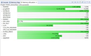

    以下是我的memory allocation 是要从这个看吗?
  • 研究了一下发现应该是我改的地方有重叠到不可写入的內存区域
    我有更改的地方是这三行
    RAMM0 : origin = 0x000050, length = 0x000600   (原: origin = 0x000050, length = 0x0003B0
    progRAM : origin = 0x008000, length = 0x002100   (原: origin = 0x008000, length = 0x001800
    dataRAM    : origin = 0x009800, length = 0x0001000   (原: origin = 0x009800, length = 0x000800
    对照存储器映射的图来看
    progRAM的长度写到保留空间去了 如果我的想法没错的话
    请问有建议更好的更改方式吗?
  • 应该是因为改到reserved区域去的原因。
    测试过progRAM的长度必须要0x002100才足够吗?能不能0x002000,这样正好在reserved之前。
  • 没错 只要小于2100 就会error
