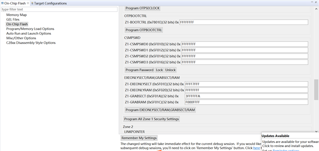

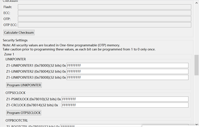

双核CPU2如何加密,CMD文件是否与CPU1一样?在\ti\c2000\C2000Ware_3_02_00_00\device_support\f2837xd\common\cmd\文件夹中有2837xD_dcsm_lnk_cpu1.cmd文件和2837xD_dcsm_lnk_cpu2.cmd文件,仿照例程
blinky_with_dcsm_cpu01是不是将DCSM_Z1_ZoneSelectBlock.asm DCSM_Z2_ZoneSelectBlock.asm加入到工程中即可?
