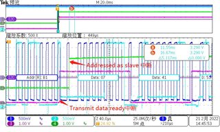

在这颗芯片的例程中,没有看到作为I2C从机的程序,我想要一个参考程序,满足以下要求:
1. 从机,8位数据。
2. 能中断响应I2C。
3. 对主机而言,这颗芯片在收到地址后能进入中断,在接收和发送一个数据后,也能进入中断。
麻烦提供一个参考程序,谢谢!

    如果没有参考例程,可否帮忙看看以下程序哪里有问题?谢谢!
    初始化代码:
        // Initialize I2C-A:
        EALLOW;
        SysCtrlRegs.PCLKCR0.bit.I2CAENCLK = 1;     // I2C
        GpioCtrlRegs.GPBPUD.bit.GPIO32 = 0;    // Enable pull-up for GPIO32 (SDAA)
        GpioCtrlRegs.GPBPUD.bit.GPIO33 = 0;    // Enable pull-up for GPIO33 (SCLA)
        GpioCtrlRegs.GPBQSEL1.bit.GPIO32 = 3;  // Asynch input GPIO32 (SDAA)
        GpioCtrlRegs.GPBQSEL1.bit.GPIO33 = 3;  // Asynch input GPIO33 (SCLA)
        GpioCtrlRegs.GPBMUX1.bit.GPIO32 = 1;   // Configure GPIO32 for SDAA operation
        GpioCtrlRegs.GPBMUX1.bit.GPIO33 = 1;   // Configure GPIO33 for SCLA operation
        EDIS;
        I2caRegs.I2CMDR.bit.IRS = 0;            //I2C Reset bit.
        I2caRegs.I2CMDR.bit.MST = 0;            //@NOTE: 0=slave mode; 1=master mode.
        I2caRegs.I2CMDR.bit.XA  = 0;            //@NOTE: 0=7bit address; 1=10bit address.
        I2caRegs.I2CMDR.bit.BC  = 0x00;         //@NOTE: 0=8 bits per data byte
        I2caRegs.I2CMDR.bit.NACKMOD = 0;        //I2C Reset bit.
        I2caRegs.I2CEMDR.bit.BCM  = 0x00;
        I2C_SetPMbusAddress(SLAVE_ADDRESS_INIT);
        I2caRegs.I2CIER.bit.AAS = 1;            //Addressed as slave interrupt enable 1h (R/W) = Interrupt request enabled
        I2caRegs.I2CIER.bit.SCD = 1;            //Stop condition detected interrupt enable 1h (R/W) = Interrupt request enabled
                                                //this for non-PEC check
        I2caRegs.I2CIER.bit.RRDY = 1;           //receive ready
        I2caRegs.I2CIER.bit.XRDY = 1;           //transmit ready
        I2caRegs.I2CSAR = 0x0000;       // The next address.
        I2caRegs.I2CPSC.bit.IPSC = 5;   // Prescaler - need 7-12 Mhz on module clk (60/6 = 10MHz)
                                        // module clock frequency = I2C input clock frequency/(IPSC + 1)
        // 10MHz/(45+5 + 45 +5) = 100K
        I2caRegs.I2CCLKL = 45;          // NOTE: must be non zero
        I2caRegs.I2CCLKH = 45;          // NOTE: must be non zero
        I2caRegs.I2CMDR.bit.IRS = 1;            //I2C Reset bit.  Take I2C out of reset
        I2caRegs.I2CFFTX.all = 0x0000;  // Enable FIFO mode and TXFIFO
        I2caRegs.I2CFFRX.all = 0x0000;  // Enable RXFIFO, clear RXFFINT,
    中断处理代码:
        Uint16 u16IntSrcReg;
    //    static Uint16 i = 0;
    //    static Uint16 j = 0;
        u16IntSrcReg = (Uint16)I2caRegs.I2CISRC.bit.INTCODE;
    	switch(u16IntSrcReg)
    		case 0x01:
    			//Arbitration lost
    		break;
    		case 0x02:
    			//No-acknowledgment condition detected
    		break;
    		case 0x03:
    			//Registers ready to be accessed
    		break;
    		case 0x04:
    		    //while(I2caRegs.I2CFFRX.bit.RXFFST < 4)  {};
    		    j= 0;
    		    if(I2caRegs.I2CSTR.bit.SDIR == 1)
    		    else//slave read data
                    RxData[i] = I2caRegs.I2CDRR;
                    command = RxData[0];
                    if(i>=6)
                        i=0;
                    else
                        i++;
                        if((command_type == 1)&&(command == 0x99))//command length =1
                            i=0;
    		break;
    		case 0x05://Transmit data ready
                if(command == 0x99)
                    //while(!I2C_xrdy());
                    //while(I2caRegs.I2CSTR.bit.XRDY != 1) {};// 1 = Data transferred tp the core TX register after shifting data
                    if(j>=7)
                        I2caRegs.I2CDXR = 0xFF;
                    else
                        I2caRegs.I2CDXR = Array[j];
                    j++;
                else
    		break;
    		case 0x06:
    		break;
    		case 0x07:
    			if(I2caRegs.I2CSTR.bit.SDIR == 1)  //means address read
    			    //address read
    			    I2C_bIsSlaveAddressRead();
    			else
    			    //I2caRegs.I2CIER.bit.XRDY = 0;//address write
    			    //I2caRegs.I2CMDR.bit.TRX = 0;
    			    I2C_bIsSlaveAddressWrite();
    			    //i=0;
    		break;
    		default:
    			//error happen
    		break;
        PieCtrlRegs.PIEACK.all = PIEACK_GROUP8;   //release other interrupt
    问题:怎样设定,可以让地址中断先发生,而数据发送中断后发生?谢谢!
