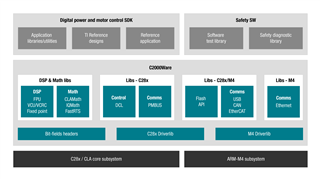

C2000目前的软件体系如下图所示:
(https://www.ti.com.cn/zh-cn/design-resources/embedded-development/c2000-real-time-mcus.html)
