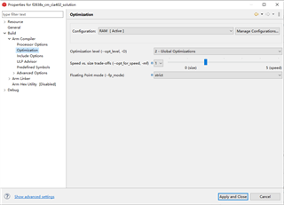

我在调试2838x_cm_cia402_solution这个例程时,发现循环体都是进入两次之后增量才加1,请问这是为什么呢?和CM4内核或者编译优化选项有关吗?

  • 你好,你的工程里面有没有使能优化?
  • 这是工程默认的优化选项 没有改过 看起来应该是开启了优化
  • 这是E2E的回复:
    When optimization is enabled, compiler may change the order of instructions, hence single stepping may not seem sequential. I would recommend you disable the optimization level or use opt_level=0 if you want a smooth debug experience. If you want to debug with O2, you may look at the Disassembly code.
    似乎优化会对代码执行有影响
